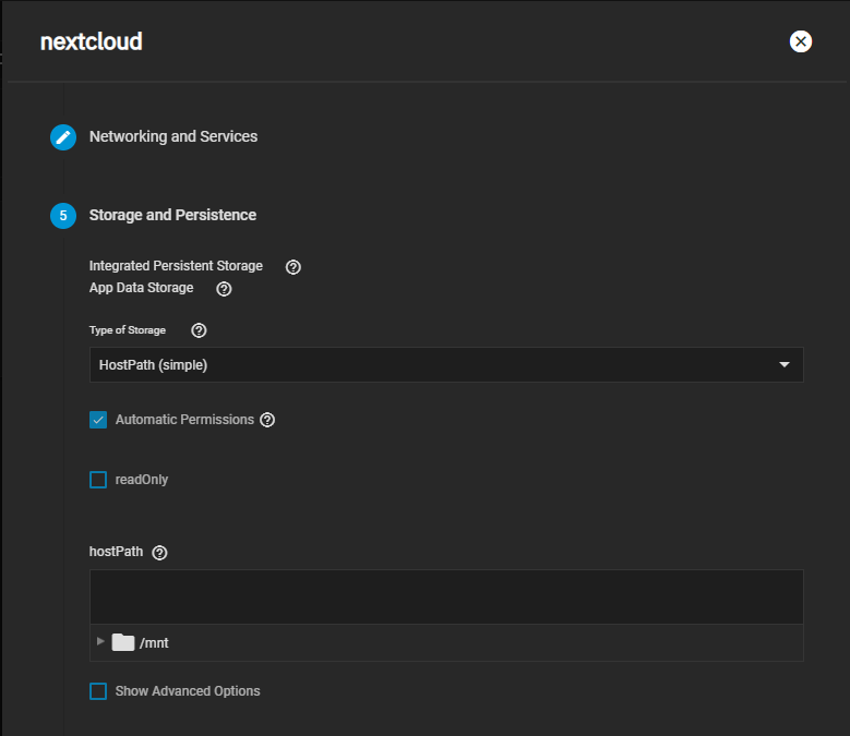

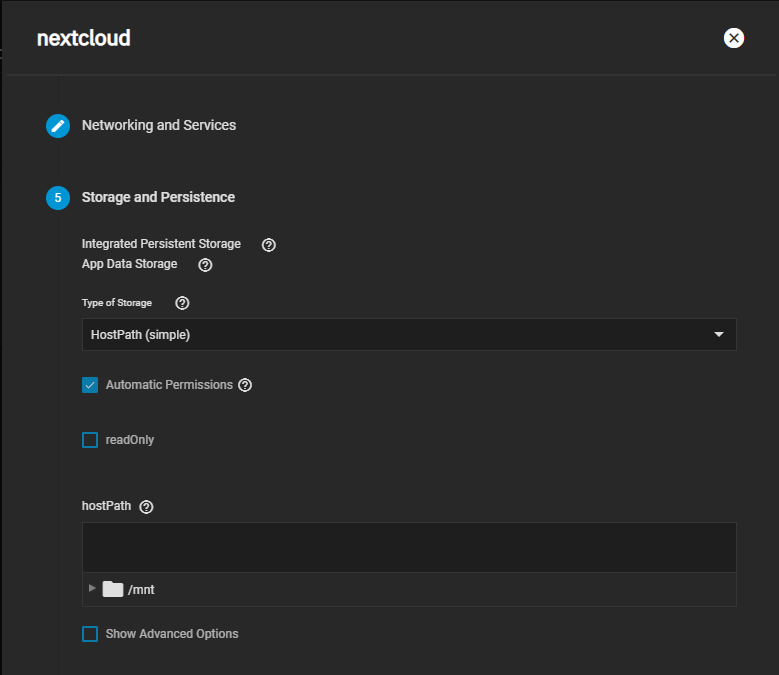

By default PVC storage isn't user accessible unless mounted, so if you wish to see the contents of your nextcloud install and do manual backups you're best off chosing HostPath when you install Nextcloud. See image below (step #5), but remember reverting and using snapshots won't be supported from inside the app.
PVC is the default method when because it supports reverting and other aspects of Kubernetes, some more info is on our website. You can also reach us on Discord if you need more info
