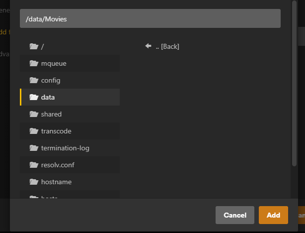

So i have a read this entire thread and understand most of it.
disabled the "Enable Host Path Safety Checks" box and now my Plex app works.
But... even with the Host Path set to the correct data sets AND SMB disabled/enabled for the sake of tests, Plex itself sees no data in those folders.
Permissions is set up so everything and every group has all permissions because #I'mBasic.
Thoughts anyone? I have already asked the plex groups similar questions that lead me to this thread which answered some of my questions but GOOD LORD this is making me pull my hair out.
(regretting upgrading from Core to Scale...)
Something seems off about the screenshot. Why does it show "data" with empty in the list and then "data/Movies" in the text field?
Maybe it would help to see if something wrong elsewhere if you can post your configuration for permissions and the share.
100% a permissions issue. I actually went with TC's version and had help installing and it seemed to fix the problem.

Are you using Official or TrueCharts Plex? TC offers support on their Discord. When you ask these types of questions, giving more config information will help. What is the dataset structure / permissions you are trying to use with Plex? What are their permissions? How do you have them passed to the App in its config?
I appreciate you mentioning this because it saved my life. the guys over on discord got me squared up and boy oh boy was it a permissions nightmare! i seriously hate permissions...
