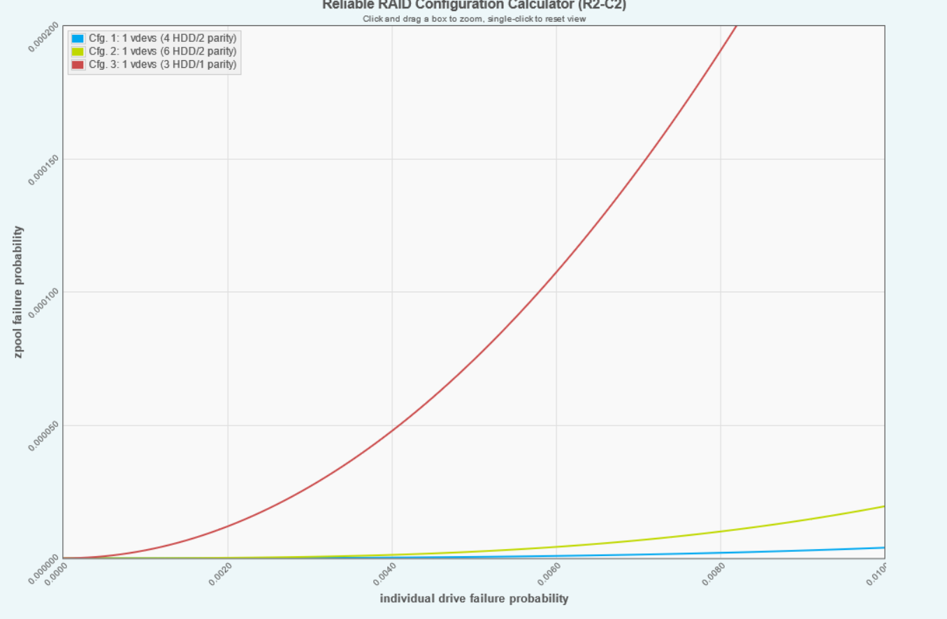

are we talking here about https://jro.io/r2c2/,
i did simulation for r5 3drives; r6 with 4 or 6 drives and here are results from the r2c2,
or am i mixing apples with pears?:)

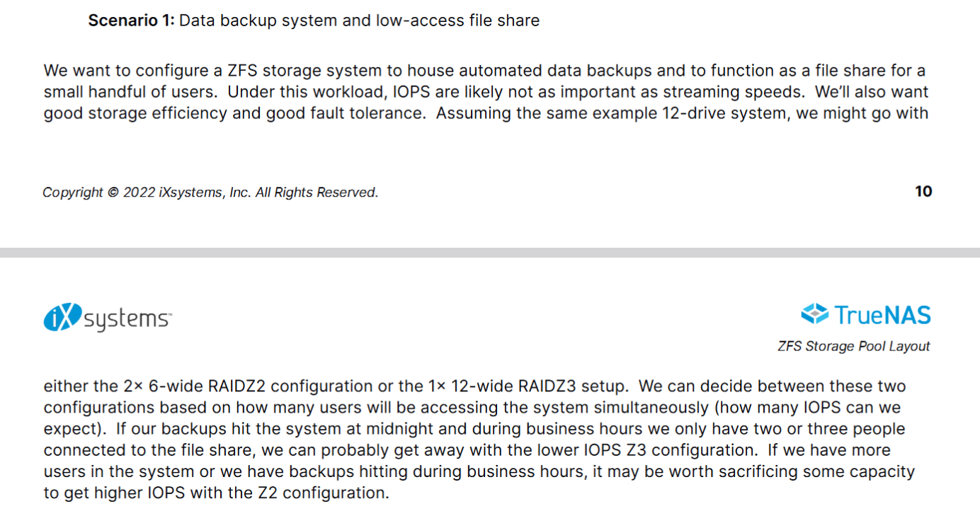

In the article ZFS_Storage_Pool_Layout_White_Paper_February_2022.pdf they are pointing out that
r6 wide 6 (6 drives) is better then r6 wide 4 (4 drives), but based on the calculation above seems its r6-w4 is better...
Thanks
A quick casual read.... I suspect that calculator is addressing complete drive failure leading to pool failure. I was pointing out the odds of a single un-correctable error per drive, which at 1 x 10^15 is about every 120Tb by my dinner napkin math. Given you have 32Tb of data, you have a margin of about 3.75 footprints. The problem only occurs when two drives experience an error in the same lba, and ZFS RAIDZ1 being only single fault tolerant then can't recover your data to map out the failure. You then lose that file or zvol, but probably not the entire pool, though I don't think that can be excluded. So... no, we're mixing apples with pears.

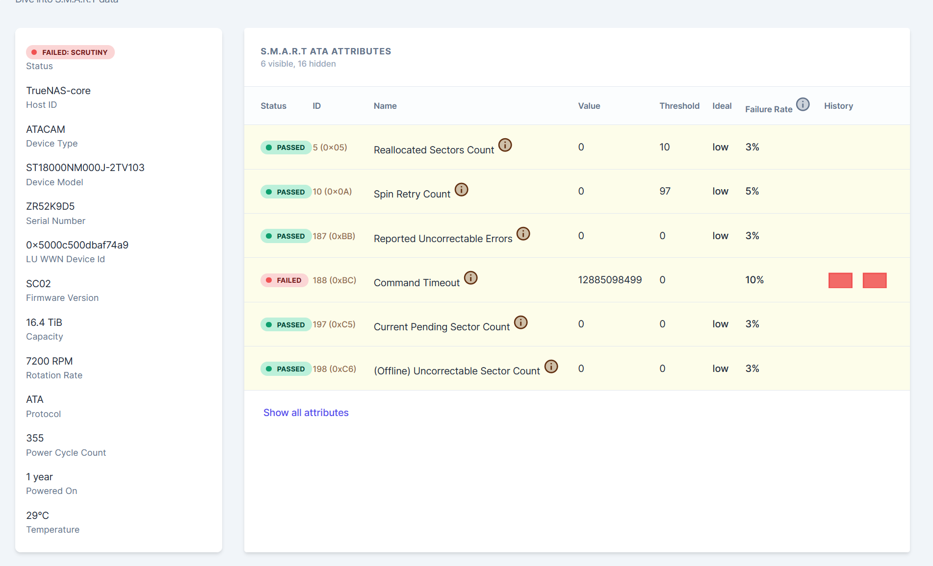

Hello @Davvo, finally get phy access so did 1)2)3);
even there was no phy access 1) that notification:
* Pool universalsoldier state is DEGRADED: One or more devices has been removed by the administrator. Sufficient replicas exist for the pool to continue functioning in a degraded state.
The following devices are not healthy:
  • Disk ST18000NM000J-2TV103 ZR52K9D5 is REMOVED
Dissappeared long time ago. I have no clue why, and i am not clear if its good or bad sign.

smartctl long report from the problematic drive - seagate finished.
@Davvo do i need to provide more additional info?
thanks
  • ada2_080124.txt

All the other values are perfectly fine, I wouldn't be so sure to mark it as broken for command timeout errors.
