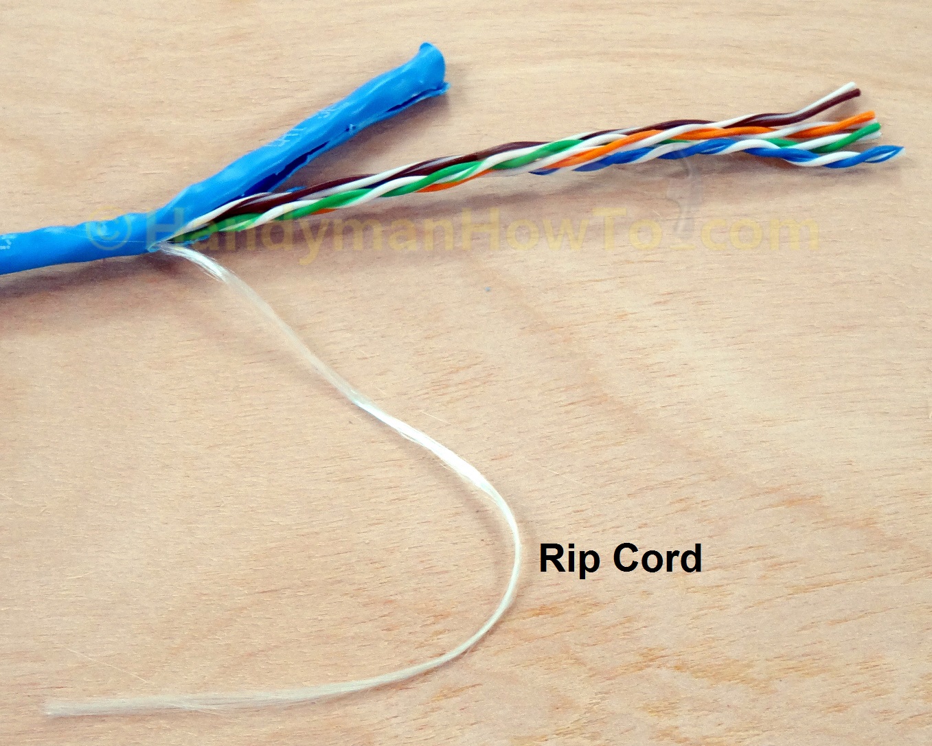

For stripping I dont use any strippers at all. I use something like this Hakko CHP-170 Wire Cutter to make small initial cut and then pull the rip cord to split isolation.(see pic) Then flip the torn insulation and cut careful with the Hako tool around it. Call me OCD if you like , but that's my way I can be sure that the internal wire insulation will not be cut by stripper blade.
Considering wires inside are twisted and that make outside cable bumpy , it's just there is no way to make perfect cut without huge risk of cutting the internal wires. So that's that.

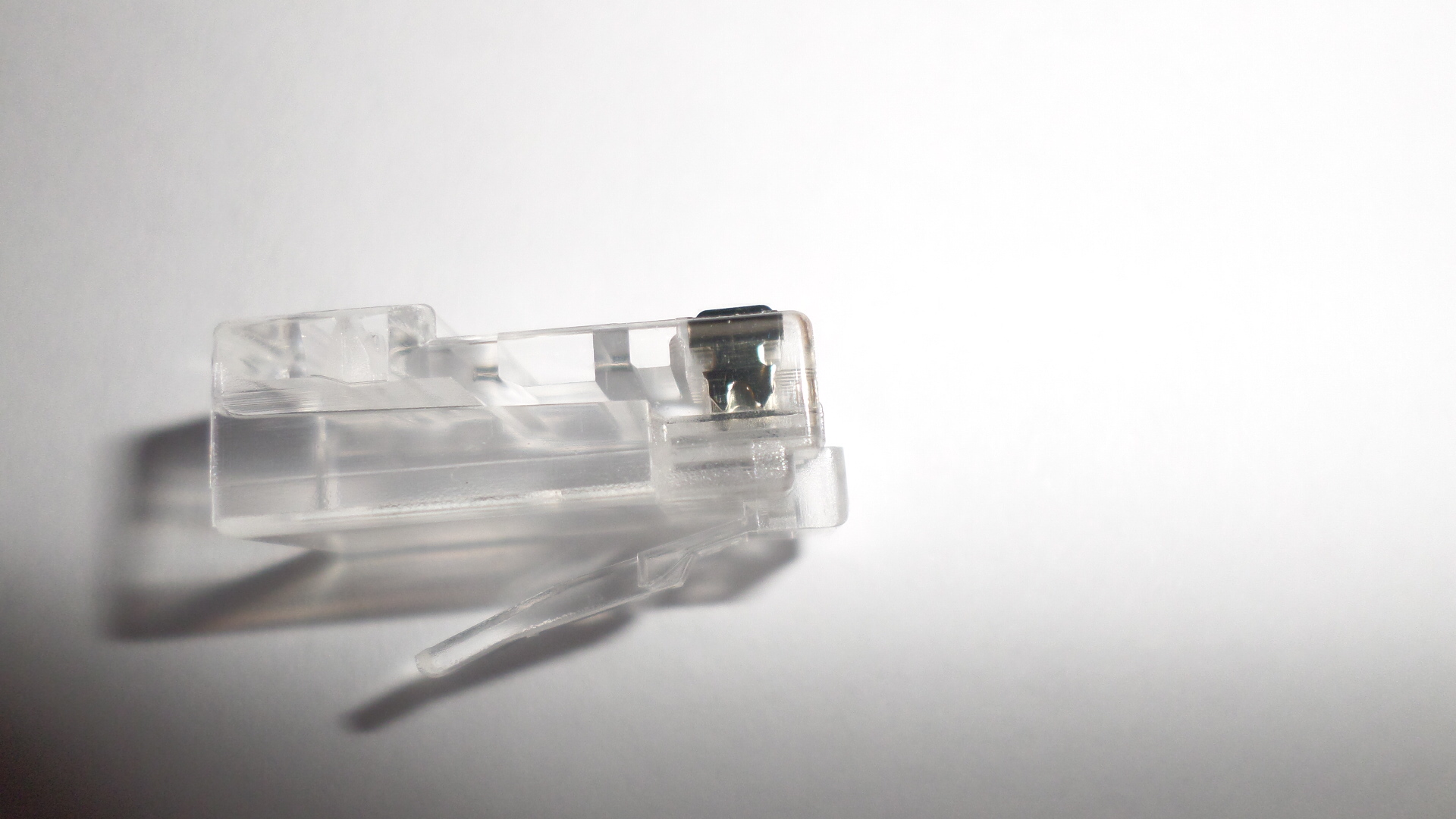

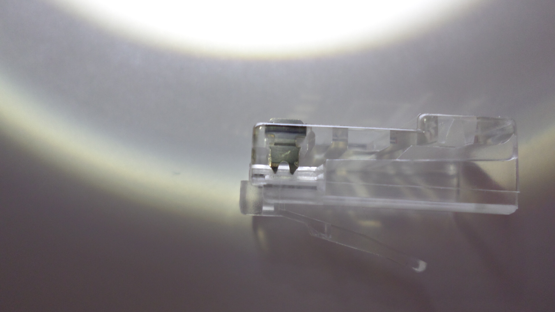

A solid wire crimp is a very special thing, with three "fingers" that slide around the solid conductor.
Now here I do admit I didn't use exactly the crimp you are showing, but I didn't neglect the fact that proper crimp has to be used. The kind I am using (from microcenter) was specified to work on solid and stranded. It looks like 2 vampire teeth twisted a little bit at opposite directions to bite the wire from both sides. I took several pictures(see pics) and I hope they are clear enough to show what it looks like.
Yeah, there are different strategies for solid crimps, the main thing is that they've got to avoid breaking the solid conductor, which basically means surrounding rather than puncturing it. Crimps rated for solid are often also rated for stranded.
Nevertheless you point is very important. I don't know why is not pointed more clear on the products itself. Considering how important is to use the right one for reliable connection and what a nightmare would be to replace a tons of connectors one already made.
