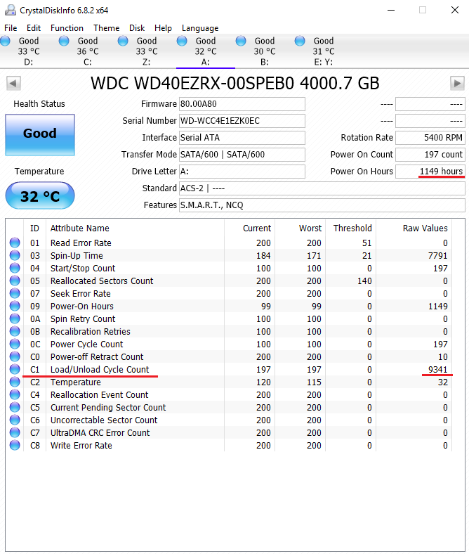

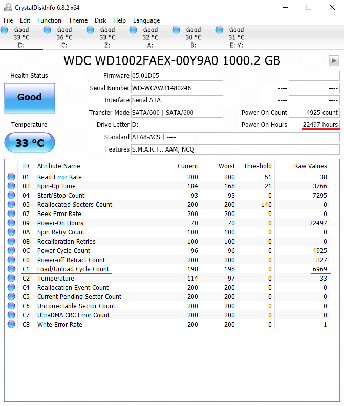

Apr 11, 2019
Thx for sharing this.
Look the difference between my wd green and the wd black.
joeschmuck
Old Man
May 28, 2011
10,996
View attachment 30016 green <-> black View attachment 30017
OUCH! The green drive is having power cycled on it an average of 5.2 times a day, the black drive is just over 4 times a day. But to address the reason of your posting, the black drive is likely being woke up every 5 minutes due to some maintenance activity (you probably have your Dataset on that drive or are using SWAP on that drive or both. Then after a minute or so the drive sleeps again. The cycle repeats forever. Your green drive looks like it sleeps a lot, just over 5 times a day and thus causing your counts to go up, but the headload count is not the issue, the drive power cycling is of concern. I know you didn't ask for any advice but that is what happens when you post to an active thread.
