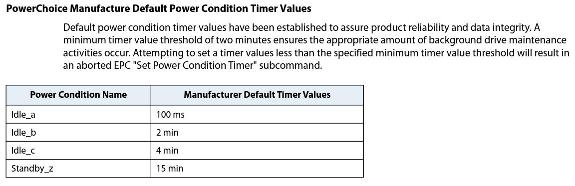

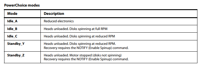

For what it's worth, I experimented a lot with this stuff in the last weeks and wanted to share a few insights...
First, the reasoning.. currently, the kWh here (Austria) costs ~55ct, meaning that my NAS with all hdds running (8x12TB w/ i5-4k) consumes around 90W, or in other words, a little over 2.1kWh per day, which would run me up to almost 400€ per year.
My drives are Seagate Exos, and apparently they come with Seagate PowerChoice, which is of course configurable. But here's a pitfall: Exos drives have their STANDBY timers disabled per default. But it can be enabled, with hdparm if you are using SATA plates, or sdparm if you are using SAS plates like me. This also means, that I unfortunately cannot use the script, but it's not necessary anyway, because the drives handle that themselves.
If someones interested, I can post the exact commands here that I used, but it's not that hard do figure it out by simply listing all available pages and change some bits here and there (This might help as well).
Specifically for the Exos drives, you can find information here: SAS models and SATA models.
Looking at some tables, you can see what the individual power states do. I did not know that even IDLE_B unloads the heads, and this power state is entered after a few seconds of inactivity.
This reduced the power consumption (with all drives spun down) to around ~50W, so almost half of what it consumed before.

This is from the user manual in one of your links, it states that the manufacture default is enabled for the SATA drives but the text in the SAS drive document does not state the same thing so I'm thinking that maybe you have SAS drives? But you would know better than I would since I do not have any of those drives. I like the Standby_Y setting, it saves some power and the drive stays spinning, but that is just me.
I have always liked the idea of using SSD's for your normal data usage but unfortunately I doubt this would work for most users here. You pay a lot for electricity so I can see how this would be a huge benefit to you. If i could replace all my hard drives with some long lasting SSD's and afford it, I would. Dang, now I'm going to go look at SSD's. My HDD's are 5 years of age, 2 years beyond the warranty. I need to start entertaining the thought of replacing my hard drives.
