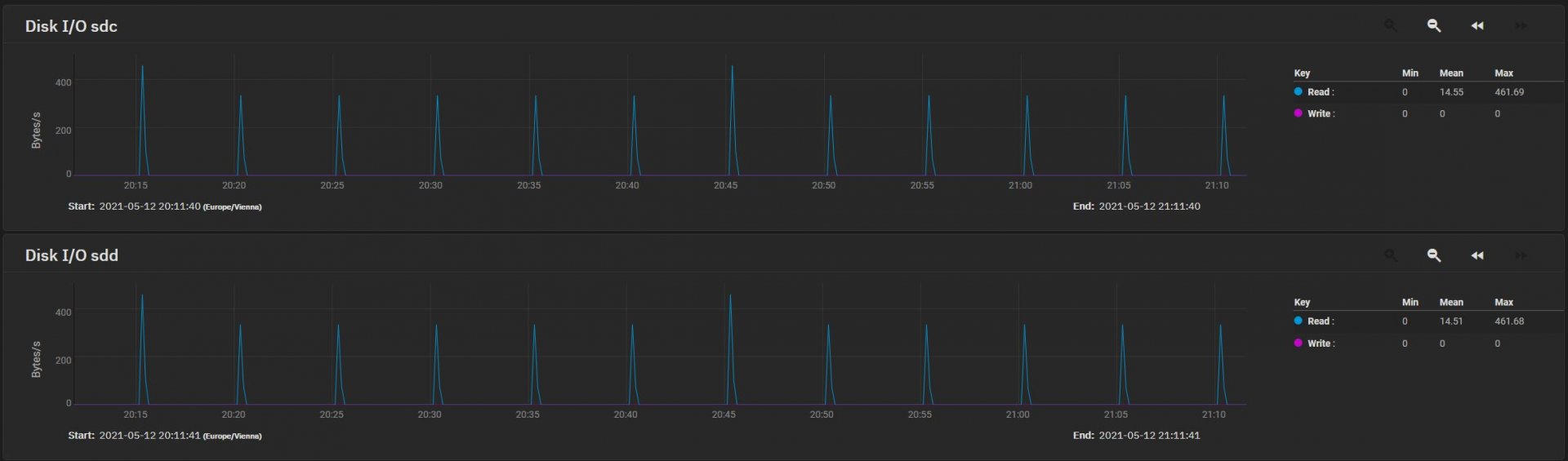

Hey guys, I cant find out what is keeping my disks awake ... exact every 5min I have a read of 335,77 and every 30 min a read of 461,68
(even with SMART interval 1440 seconds, or disabled)
Goal is to have them sleep as long as possible, as they seldom get used, sometimes not even for weeks.
The frequent used data is stored on SSD mirror, those HDDs are only archive.
As its a home NAS which idles around 5-7Watts, two running HDDs push it to 17-20Watts,
so IU prefer to keep it as low as possible. The whole box is also passive cooled and
housed in my living room, so noise is also a reason to keep those HDDs sleeping.

I guess I've found the culprit here...
As I said I disabled SMART directly in the extra Disk options (Storage -> Disks -> sdd ->...) and suddenly it worked.
To find out if thats it, I reenabled SMART on only ONE of the two disks, resulting in this:
nas02# hdparm -C /dev/sdc && hdparm -C /dev/sdd
/dev/sdc:
drive state is: idle
/dev/sdd:
after a few minutes:
/dev/sdc:
/dev/sdd:
drive state is: standby
And in the io graph under Reporting I see reads on the one Disk with SMART enabled and a NULL line on the Disk with SMART disabled.
After disabling SMART for both disks:
/dev/sdc:
/dev/sdd:
For now thats working for me, but it would be nice for the future, to have SMART running while keeping the disks in standby/sleep/spindown.
They stay spun down, even with freenas-spindown-timer.sh cronjob disabled.
But as I remember, the reason for the script is to have the disks spin down, while retaining SMART functionality, soooo the script is actually not working for me.
BUT the drive associations are changing between boot, the HDDs may be like sdc sdd, but after the next reboot, they may be sdc sde.... so I cant start the script automatically with the right drive associations, that may contribute to the problem. Does it also work with UID?
