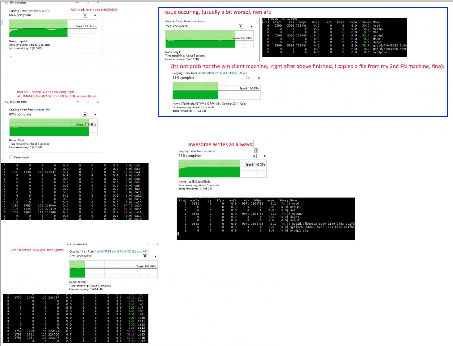

EDIT; i figured i would add some quick screen shots, i literally have 100s of other screen shots, trying to ID this issue- but these are some quick ones i made just now, it only started doing it for about 10min on 1x of 2 FN machines (both are fresh/clean installs with nothing running but SMB and SSH and NFSd). you can see in blue box, the issue started happening (TOP on the FN box shows nothing unusual), and right after i did a copy from the 2nd FN machine, just to verify its not something on the win box im testing from (read from 2nd server ran fast). while it shows 656 MB/s, its usually a bit wrose when it happens (ie ~450-600mb/s), and even if i copy the same file RIGHT after (so that it comes from ARC the 2nd time, and i see little/no disk IO), the speed will still be "capped / slower". tks
