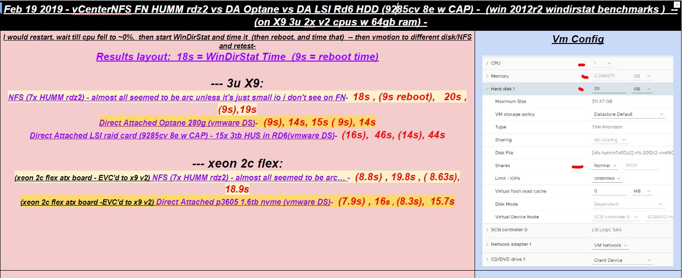

im still playing with/testing my new layout / config and made some benchmarks. so i figured i would post them here. its from my own notes, so it may be hard see what going on, but ask any ? and i'll answer.
brief setup- (esxi 6.5u2 patched to jan31 2019), i have 2x hosts with no other vms running (so idle). (and vcenter appliance is running on a different unrelated box).
I have a win 2012r2 VM , fresh install (and updated), nothing else but chrome installed. I would then time how long it took to reboot , and time to run WinDirStat app on C: (app which shows you directory utilization for all your files/folders, so heavy, random read of entire drive).
on reboot, i would start my stopwatch as soon as the screen went black, and stop as soon as i got to the prompt asking for press CTRL-ALT-DEL to enter your password.
The "NFS" data store, is from a FN 11.2 box, on a sm x9 DP board, with 2x e5-2620 v1 cpus, and 128g ecc ram. (almost all of the READS from FN are coming from arc it appears though, so more a test of FN ram/network IO). all devices have 10g , via DA SFP's to a ubnt x16 10g switch, on their own vlan. After i would run test, i then storage vmotion to the next disk type.
(9s) = reboot took 9s , 14s = windirstat took 14s (ie the parenthesis time = reboot). The results are in red text.
host1 is x9 DP board, with 2x 2620v2 cpus and 64g ram.
host 2 (the "xeon 2c flex atx") is a X10SDV-2C-TP4F (pentiumD , 2 core, which is really a Xeon-D cpu, soc board)
(even tho this is almost all read, no write, - FN pool/dataset is set to sync=std , so is SYNC writes)
any other ideas to test this setup, lmk. tks
EDIT; even tho its all ARC, the nfs FN RDz2 vol is 7x 200gb HGST sas3 ssds - HUSMM8020ASS201
