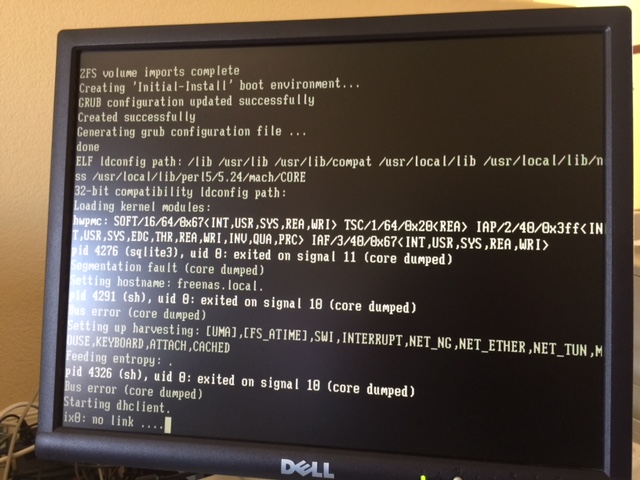

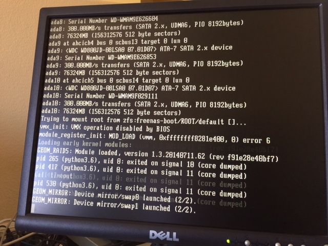

Hello,
Are there any know issues with the X7DWN+ MB and FN 10/11 series?
I have searched but have not found anything conclusive.
It seems that whenever FN is booting on this MB, there are a lot of these:
pid 123 (python3.6), uid 0: exited signal 10 (core dumped).
(Different PID numbers and names, and some are signal 11)
Also, some tracebacks, 'bus error (core dumped)', and 'Segmentation fault (core dumped)' messages.
FN 9.10, for example, boots and runs normally.
Things I have tried:
1- Flash BIOS with latest available version.
2- Reset BIOS to default settings.
3- Different memory modules.
4- Several memtest86 runs on those modules.
5- Remove all add-in cards.
6- Different USB sticks for FN boot (same sticks work fine with FN 9.10)
7- Sata Hard drive for FN boot.
8- 2 different USB hard drives for FN boot.
9- Verify checksums on downloaded ISOs.
10- FN Corral-Release, 11.0-U4, 11.1-U1, 11.1-U4, 11.2-MASTER-201805230453-5130bd1 (all produce similar results)
11- Install from ISO to USB/USB HD, SATA HD on 2 different computers and then booting the X7DWN+ from those.
12- Install FN 9.10 and then using the Update menu to update it to higher version.
13- Boot one of the USB drives with Corral installed on another MB: Supermicro X7DBE (no issues with that one).
14- maybe other things I forget.
It seems something about this MB is tripping out FN 10/11, but 9.10 has no problems with it.
And hardware tests seem to come back normal.
Thoughts?
Thank you.

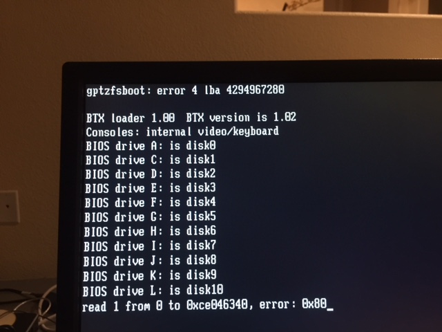

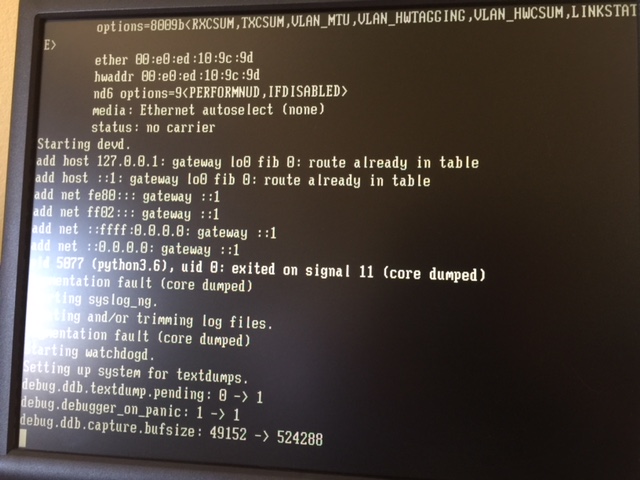

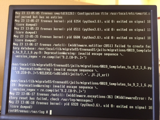

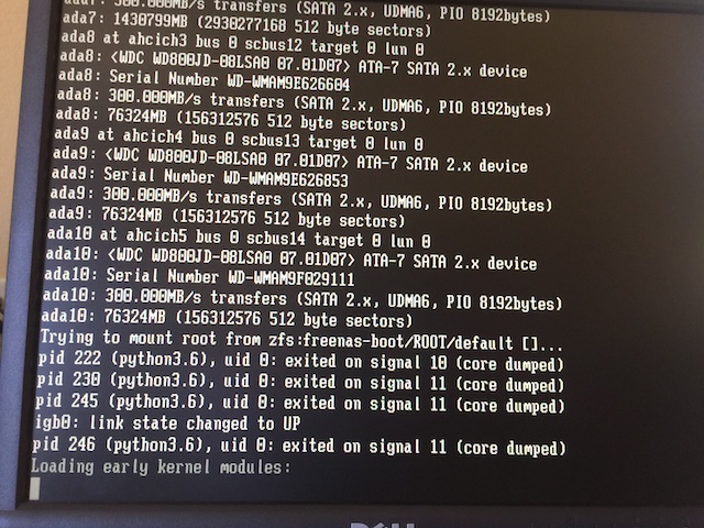

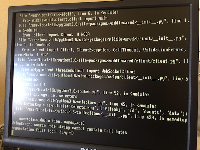

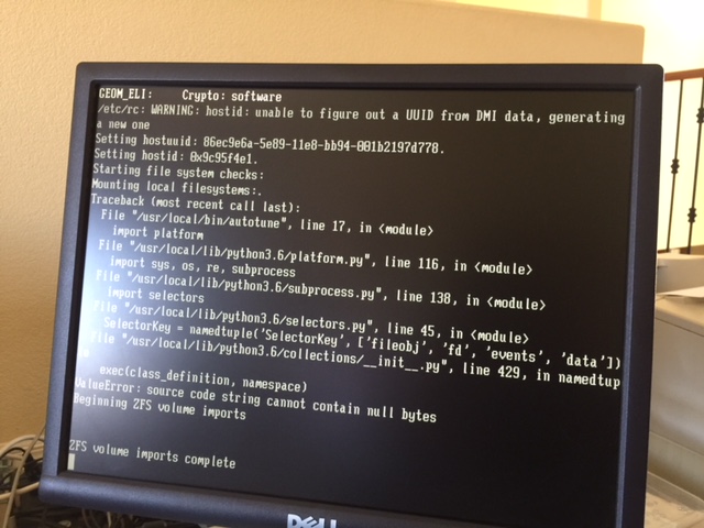

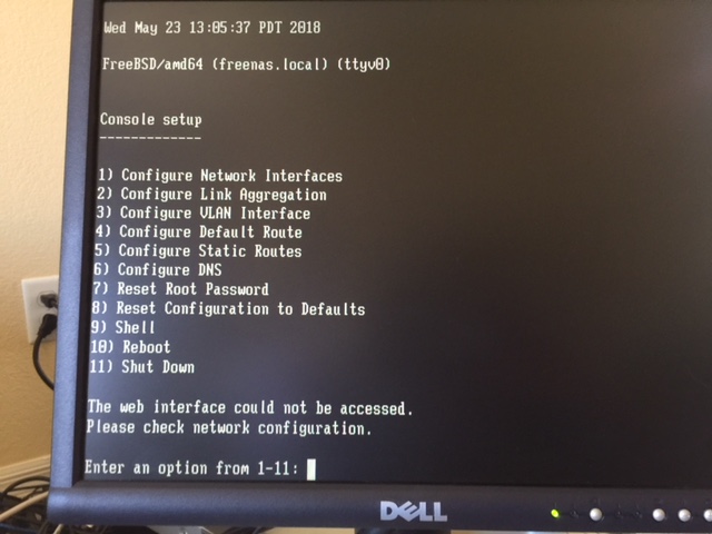

Here are some pics, in no specific order, of the issues booting FN 10/11.
(I think the pics are of 11)
The order of events matters, for example, this menu indicates that the system is booted and ready, it just needs an IP address:
index.php
Sometimes it would boot with an IP, but the web UI would keep crashing/restarting.
Other times it would not pick up the IP address (But the interface did have an IP on it already and could be pinged from another device on the network)

Python just seems to be crashing all over the place. I don't know how that would be caused by functioning hardware, but it wouldn't surprise me if the hardware was, in fact, not working correctly.
Got2GoLV
Jun 2, 2011
26
Hardware issues was one of the first thoughts I had.
But, FreeNASs 9.10 and earlier run fine without any issues on that same motherboard setup.
And, NAS4Free based on FreeBSD 11.1 also runs without any issues.
I would expect a hardware fault to exhibit issues in other OSs as well.
I guess it's not impossible, although unlikely. Perhaps someone with that same motherboard might post if they too have issues, or if they are running 10/11.x without problems :/
