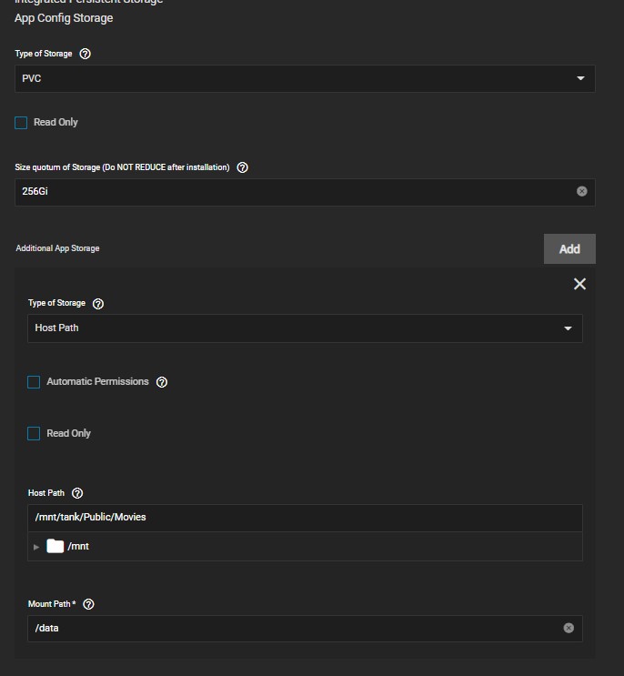

browntiger
Oct 18, 2022
58
My Plex is set to SMB share. Permissions are nor well though off [but I never had a chance to rethink them]. But it works just fine ...
Used TrueCharts deployment with near 0 changes. The only thing I did was mapped my SMB share folder HostPath (must be accessable by group apps or user apps ) to something like /data in addition to PVC with 256Gi. When you start just add a library pointed to your /data.
There is NO reason to use "bridge" or switch to VM. Kubernetes (used by TrueNas) have mandatory supported objects: "volumes".
These objects are specifically designed to provide access to the external storage.

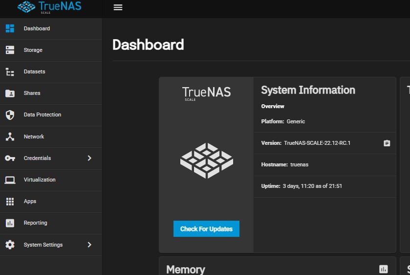

What do you think I am running?

Sweet. I wonder how that is working? They stated it’s blocked. Are you enabling the share after you get the Plex app started?
browntiger
Oct 18, 2022
58
Who?
No
I map a folder under the SMB share. Not the share itself. /Public is an SMB share. /Public/Movies mapped as /data
And I don't see why would someone even try to disable this. One can always make a path so complicated under Linux, one would loose their mind checking. Like with Linux soft or hard links, where parent folder is not the same as a starting with "..". Most developers would loose their minds accounting for all combinations and give up.

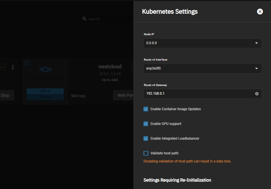

This will be better documented at release, but to access an App dataset via SMB or NFS you need to disable host path validation in Kubernetes settings. This is a new "safety" feature in Bluefin. Some Apps are not very compatible with SMB sharing...
