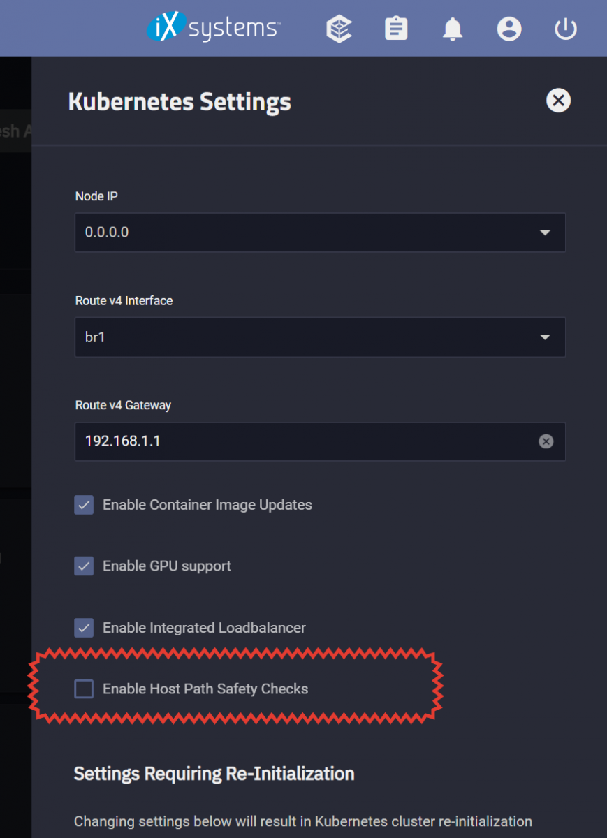

LarsR
Oct 23, 2020
719
@essinghigh
Your Problem is the hostpath validation that got implemented with bluefin.
That validation prevents Apps from starting If the Same path is used for hostpath and smb Sharing.
You can either disable the hostpath validation in the advanced Options of your App Tab or, in Case you use truecharts Apps, switch from hostpath to NFS. Truecharts provides a Guide on their Homepage.
DowJones
Mar 13, 2023
@LarsR, thanks
It's all about this checkbox
