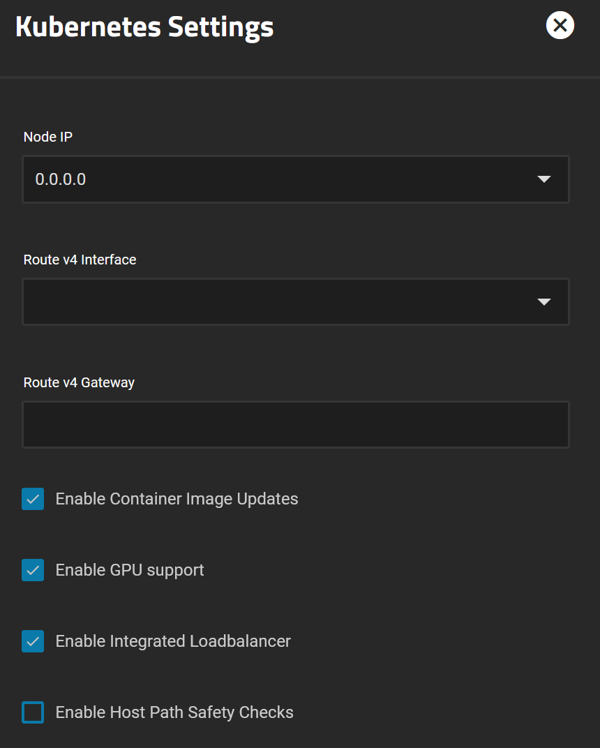

Feb 13, 2021
3
In Applications, go to Settings > Advanced Settings, and uncheck Enable Host Path Safety Checks. Save, your containers will restart, and you won't have this conflict anymore.
