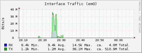

I have changed a one of my Smart TV with a NEW Bravia 4K HDR, and, of course, I have tried to store a 4K from a remote server. This file have an high bitrate ~45 mbps. The connection in both place server and tv aren't bottleneck (Gigabit Optical Fiber). The server have a strong CPU (Intel Xeon E5-2670).

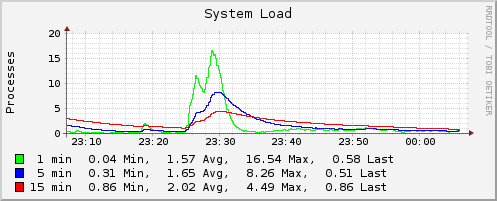

When I tried to stream I can see the video without problem for around 20s after that there's a fast lag and the message "Your server isn't power enough bla bla bla..." appears. What I want is to find the real bottleneck:

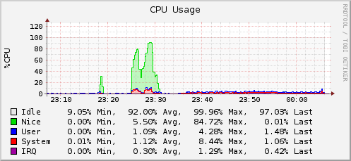

1. CPU: It don't think is the problem, I have started a concurrent trasconding without problem and the graph show me only 70% of usage...

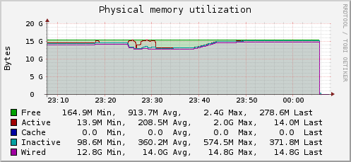

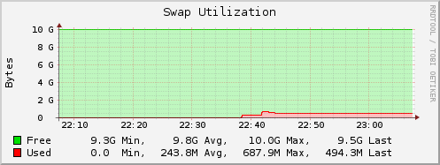

3. RAM: I think is the most likely, I have see a little SWAP (look at the photo) and when I try so look at the Plex logs I see a lot of
VERBOSE - [TranscodeOutputStream] Waiting 100ms for more data...
but it strange that, if there isn't enough RAM, the second concurrent stream work well...

Is your Plex client the new TV? If so, is it capable of direct playback without transcoding? If I understand it correctly, transcoding a 4k stream is like telling Plex to transcode 4 concurrent 1080p streams which theoretically, your E5-2670 should handle just fine. In practice, however, it may not be able to keep up for various reasons.
You might want to search the Plex forums for more answers. I know this is a common issue with 4k video transcoding.
