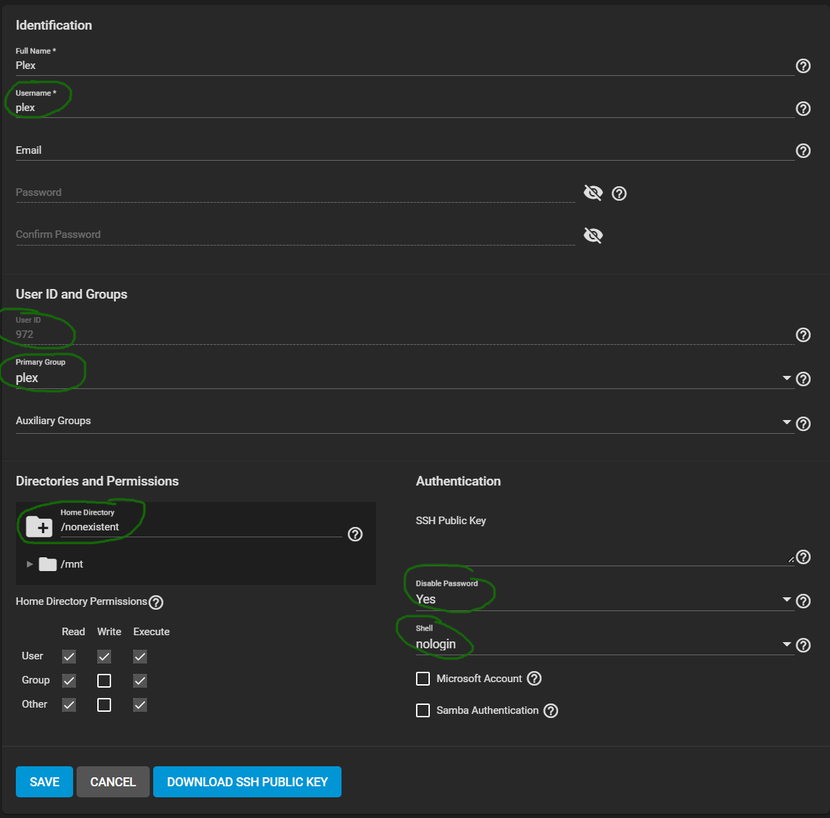

I do not seem to have a plex group so I should create one in true nas and give it read file permissions to the mountpoint?
Yes.
In TrueNAS proper, you need a UID/GID (user/group) that matches the one automatically created in the Plex jail. When the plexmediaserver daemon runs in the background (inside your jail), the process is owned by the user ID 972 (which is the user "plex").
In order to access the folder (and the subfolders and files within), your real media folder in TrueNAS ("Plex_Media") needs to allow the UID 972 and/or GID 972 permission. This can be applied in the GUI for the dataset's permissions, or in the CLI. You can use either the traditional Unix permissions method or the more nuanced ACL method. (You should apply it "recursively" so that it applies to all your subfolders and files.)
In order for the above to work and make sense, you should also create this "plex" user/group (972/972) under Accounts -> Users, something like so:
Doing this should automatically create a group named "plex" with the GID 972. If not, then you need to make one manually under Accounts -> Groups, and set the user's Primary Group to it.

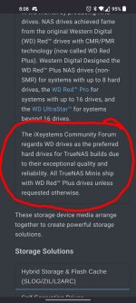

Sorry for the OOT, but I'm trying to build my TrueNAS server around a similar hardware and I've been told that it won't work properly with a non-ECC system and particularly using those WD Red HDDs (-EFAX).
What's your experience so far? Thanks!
fine and truenas recommends those drives in their documentation and it works on non ecc hardware they just don't recommend it. I also switched to scale as I have more experience with linux.
Well, afraid that drive comment is not correct - please see https://www.truenas.com/community/resources/list-of-known-smr-drives.141/ for a discussion of the topic.
With respect to ECC memory, that is your choice based on criticality of your data. Search the topic here - it’s been discussed many times. “Lots” of users are happily running without it.
Read the documentation of the actual operating system before commenting because the drive is smr and ix systems machines ship with wdred drives.

Well, No - they ship with WD RED PLUS drives which are CMR.

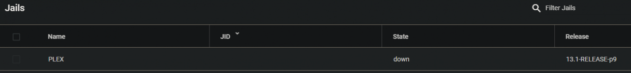

I tried to do this for my plex media server however it is still showing up greyed out.
I have the "plex" group id set to 972 same with the plex user account.
This is how my Jail properties appear for the plex plugin as well.
i've been scouring the web to try to figure out the issue (i still get greyed out 'Media' Folder on the plex website itself)

Yes.
This worked for me as well. I was having a condition where either my share had no permission, or my Plex had no permission. Adding this user/group solved it, now I can see it both ways (I had to disable the memory check for Kubernetes as per this thread: https://www.truenas.com/community/t...-to-service-s-smb-share-snapshot-task.101763/). I understand I need to do a system security check after I'm done with all the setup, to make sure I didn't create any unintended holes...But "working" is a huge step forward.

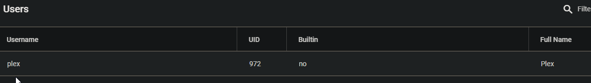

Hey Everyone,
I am facing the same issue where Plex can not see anything outside of it's jail. Following the solution above, here is what I have so far.
The plex user was created with UID 972
It is a member of the Plex group (also with UID 972)

Oct 22, 2019
3,641
UPDATE: Read this first. It's more important.
I created the directory via SSH so I wonder if if could be the mount point path or the properties of the directory itself...
This is bad practice. It means you're (attempting) to save files directly into the pool's root dataset. You should instead create child datasets below the root dataset, and those are the datasets you save your files to. (I would correct this first.)
This is only relevant once you correct the above, first.
I can not see "Pool_A" within /mnt/ when adding a directory in plex.
Try something like this, when configuring the mountpoint(s):
Source: /mnt/Pool_A/Movies
Destination: /mnt/Movies
The reason it appears "empty" is because you're looking at the root folder of where the path begins (i.e, after /mnt/Pool_A/Movies/), so from the jail's perspective, its own /mnt is going to be an empty directory.
