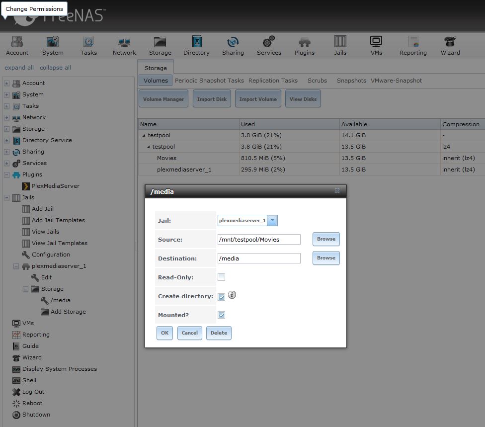

If you setup the plex
Just manually type in: /media
In my example I have a dataset called "Movies" and then I setup SMB (CIFS) shares but only so I could move a video into the dataset, you don't need the SMB share for Plex to work. Also notice that I reference /media for the location inside the jail (plugin).
