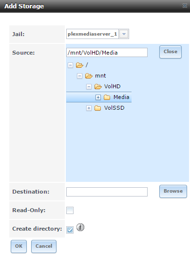

Yes I did. When I select the Jails tab and go to the Storage button I see the following.
Joshua Parker Ruehlig
Dec 5, 2011
5,949
you mounted it to /media. Why are you looking in /mnt?

When I add the storage I browsed and that is what FreeNAS did
I'm not sure what you are asking. I think it is pretty clear where you mounted your "Media" dataset, is not where you were looking in the jail with 'ls -l'.

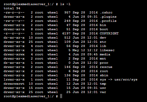

I see what you mean. Forgive me I have little experience here. I thought the command would show me all my mounted drives that plex can see. I just now ran "ls -l" and see the following.
My main question is why my plex is not showing the movie files I placed in /mnt/VolHD/Media/Movies. Now that I have this new ls result how can one tell what directory is in the jail and which is from my dataset outside the jail?
You can tell based on what you entered on the Jails > Storage tab. You mounted the Media dataset to /media, so your files are in there.
