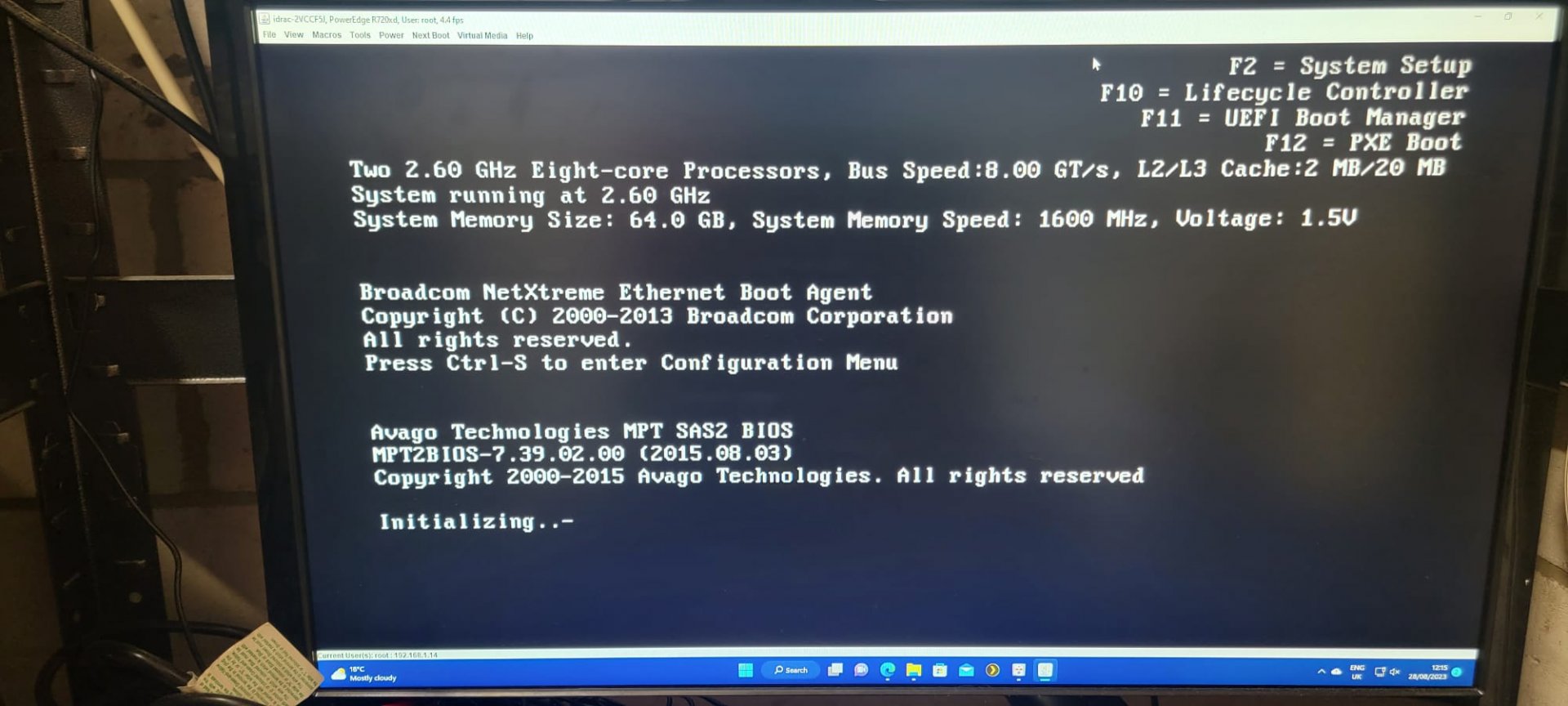

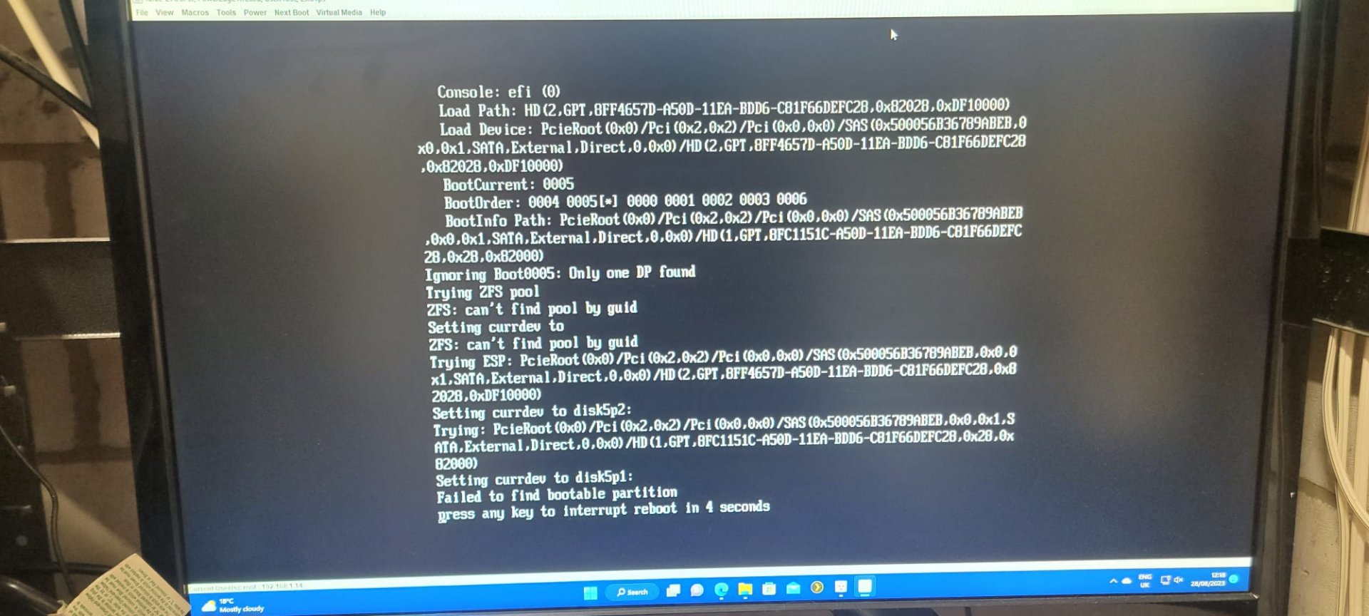

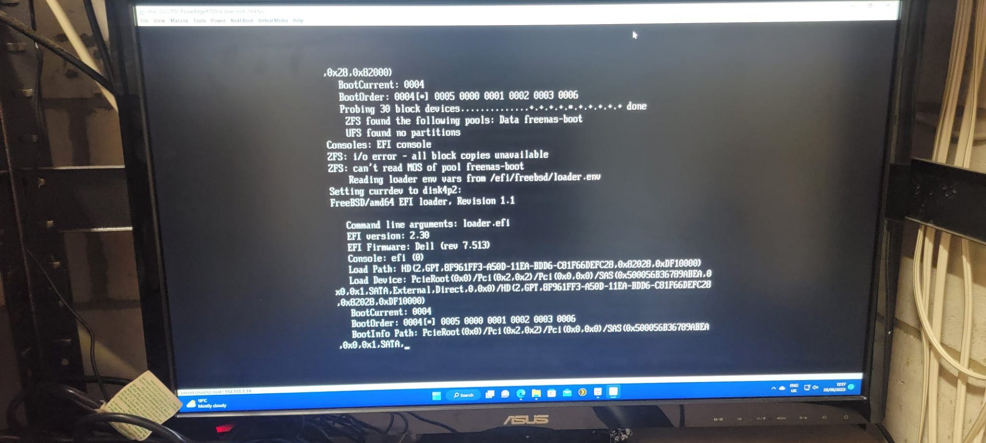

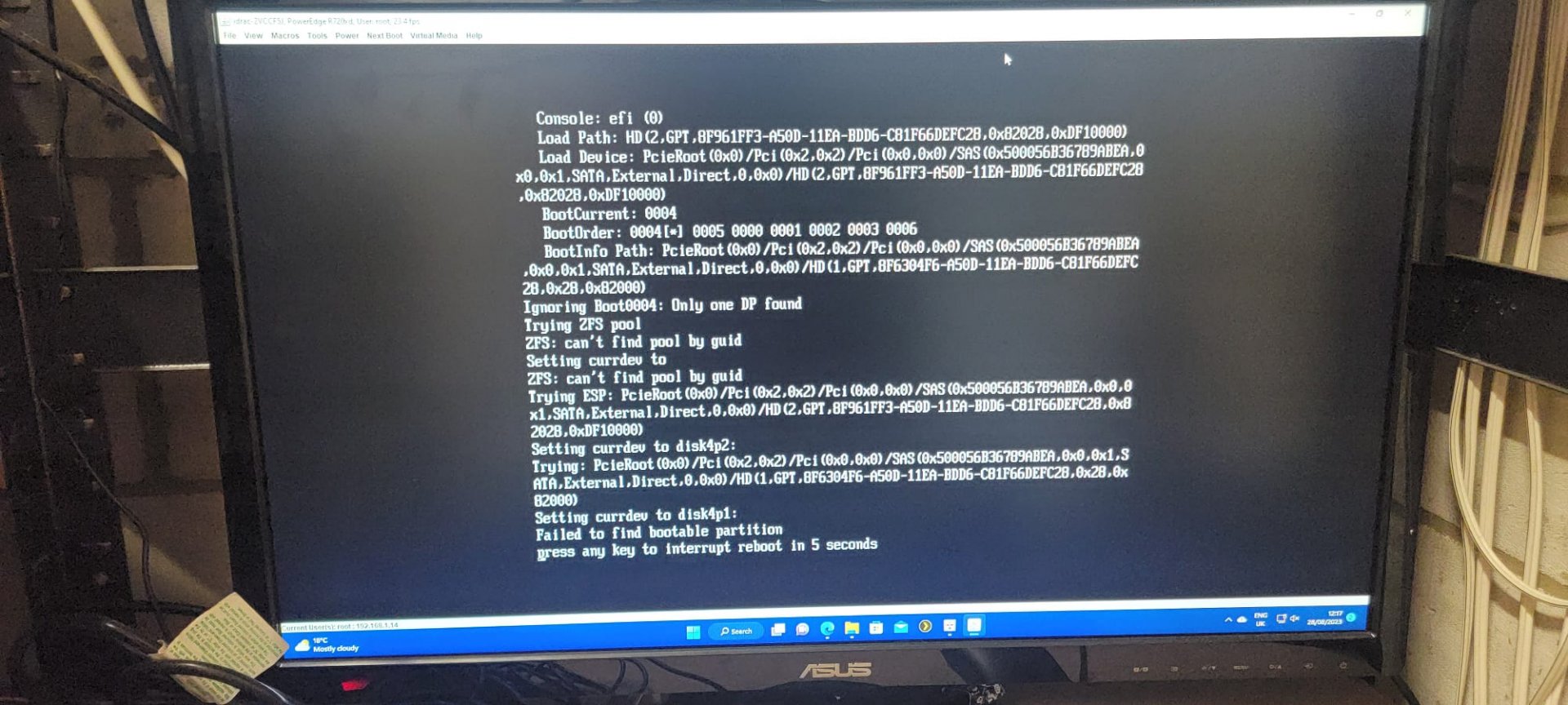

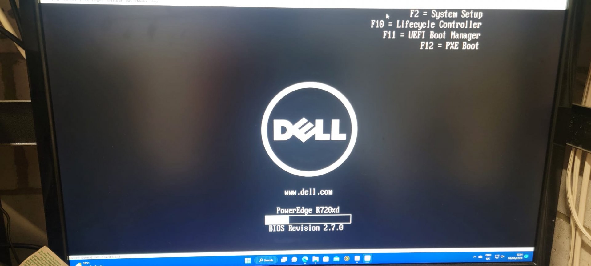

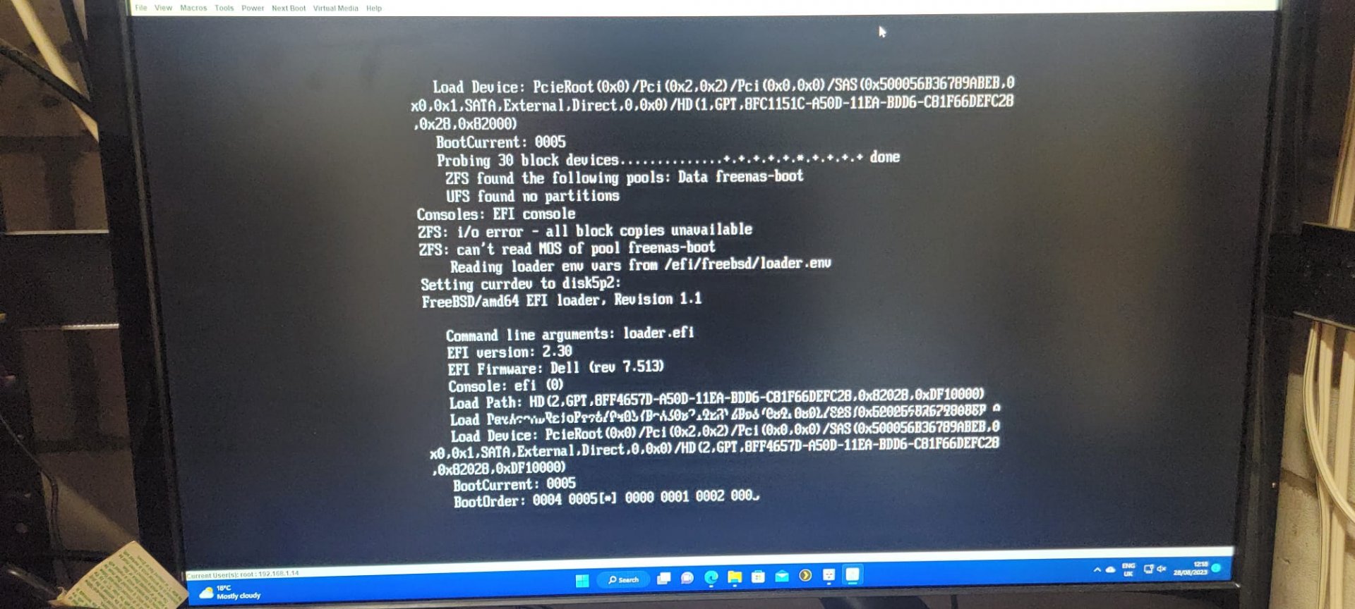

Dear All,
Please Help, I have a Dell poweredge R720XD,
2x SSD which run True nas
8x hard disk which have my data on it.
I just use it for storage and use another PC to run Plex which has a network drive to my truenas server to pull the data from it.

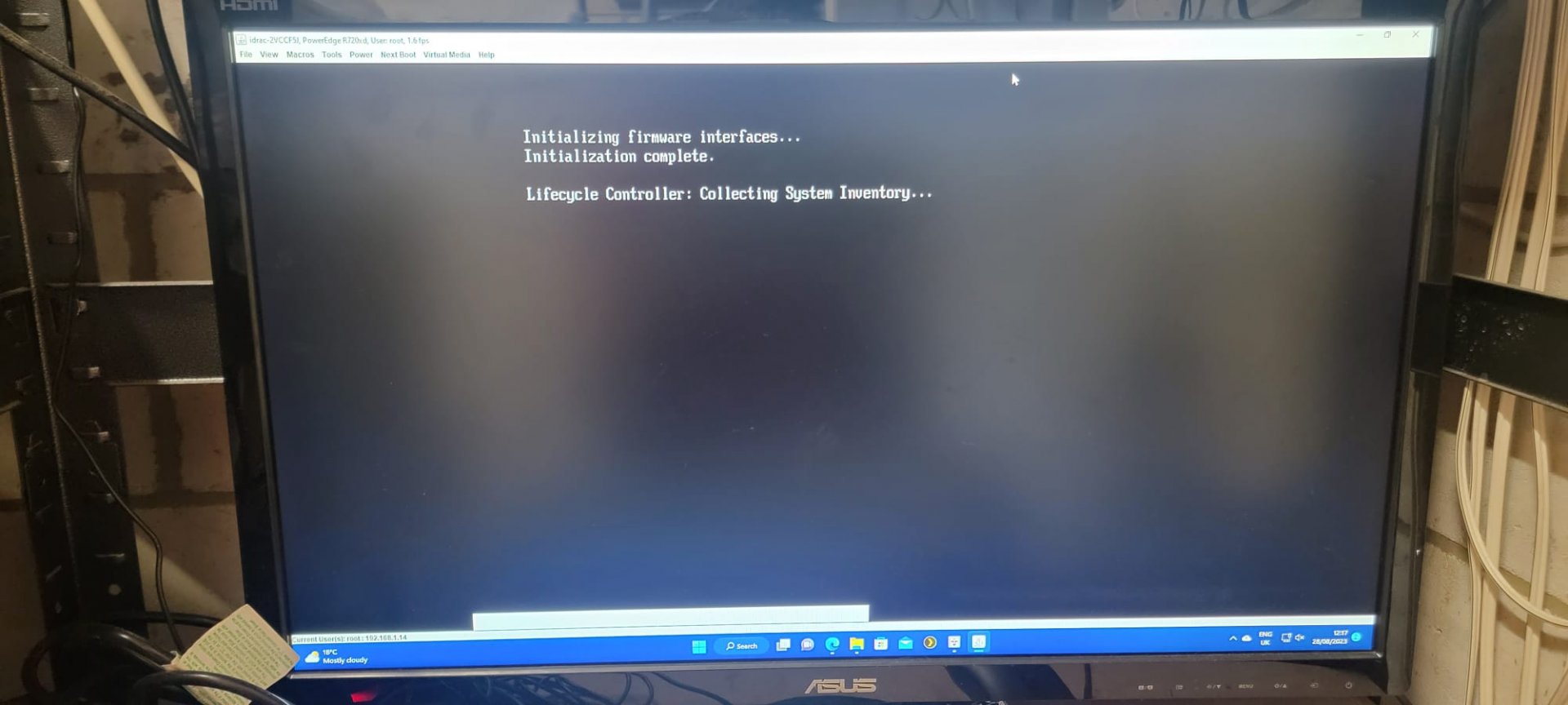

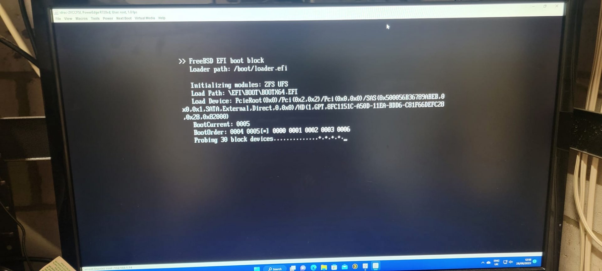

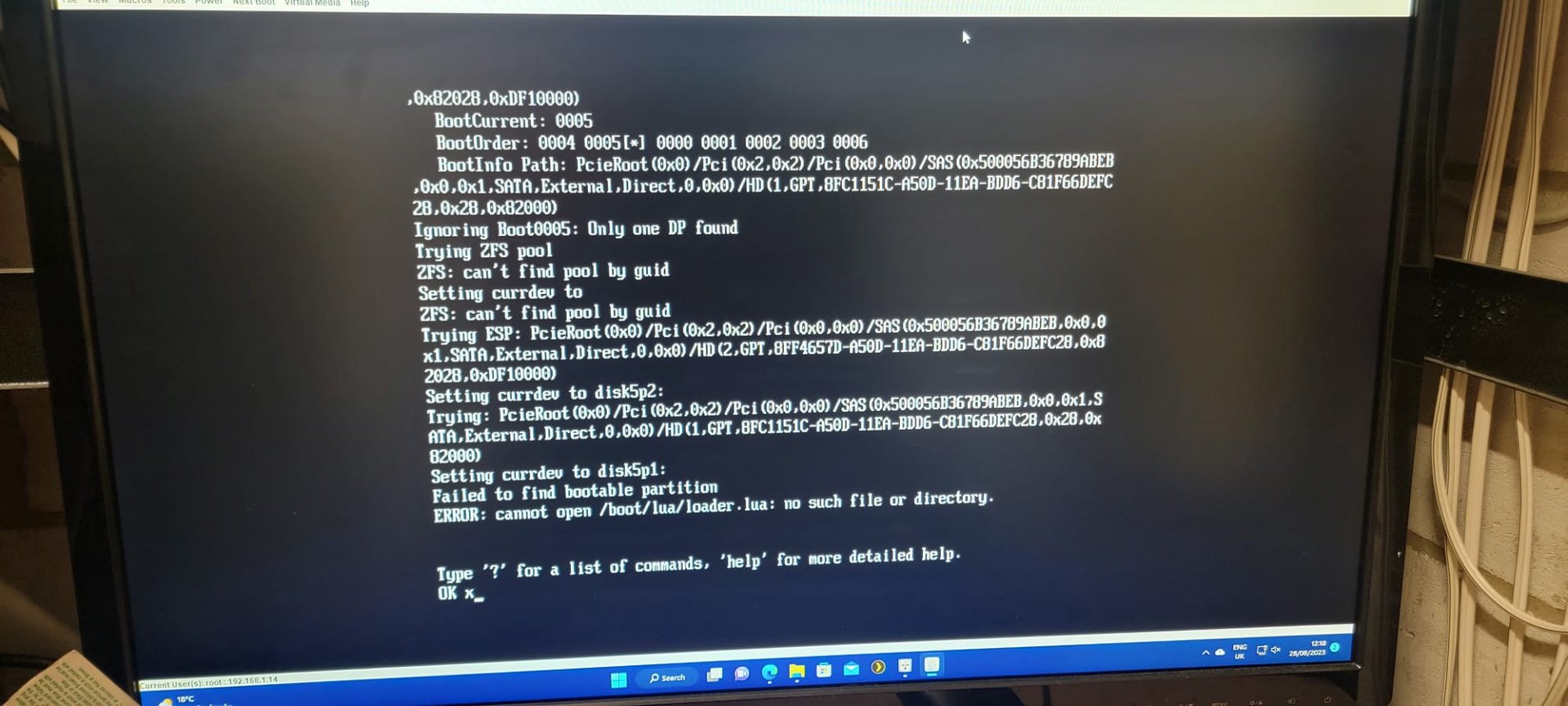

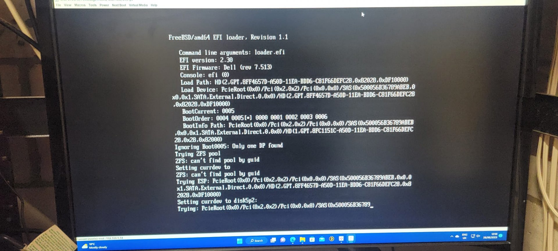

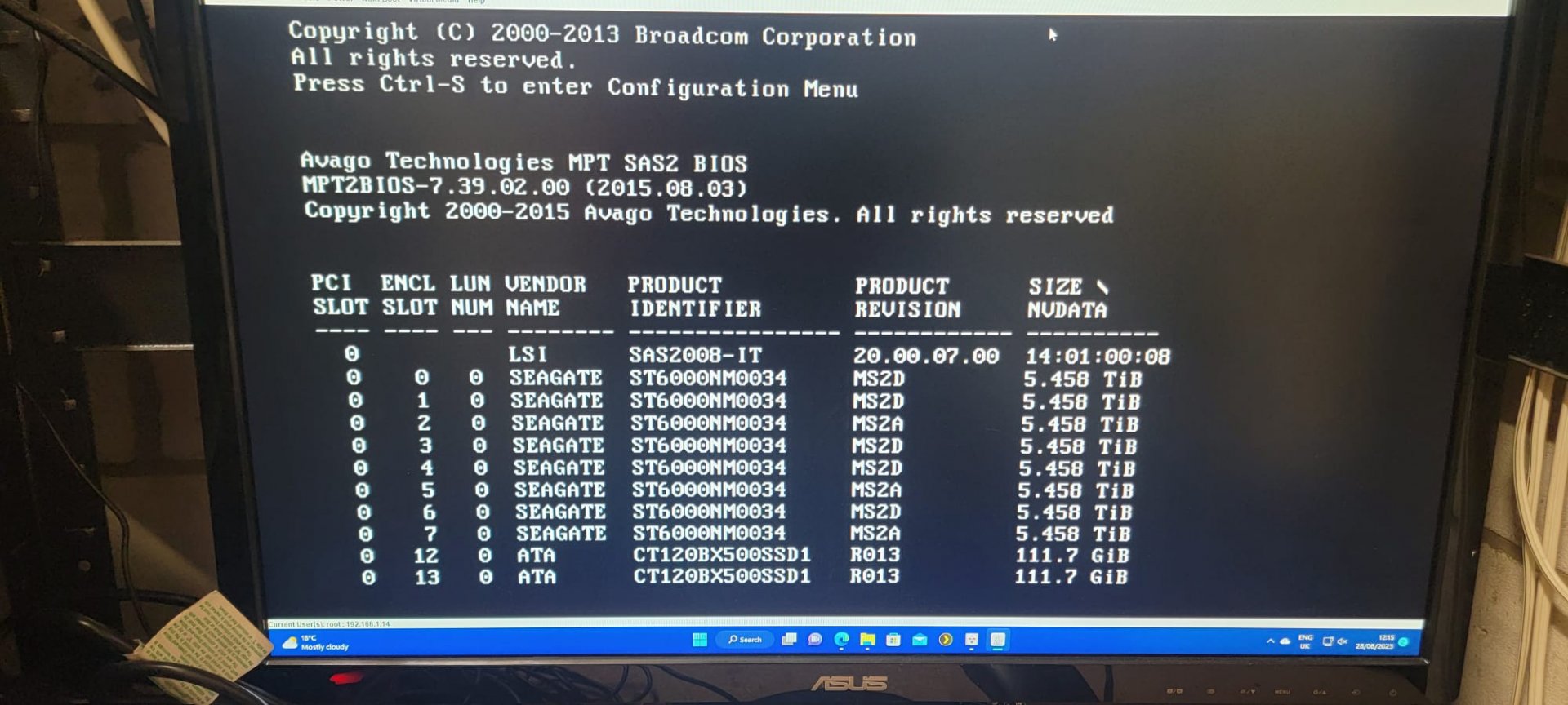

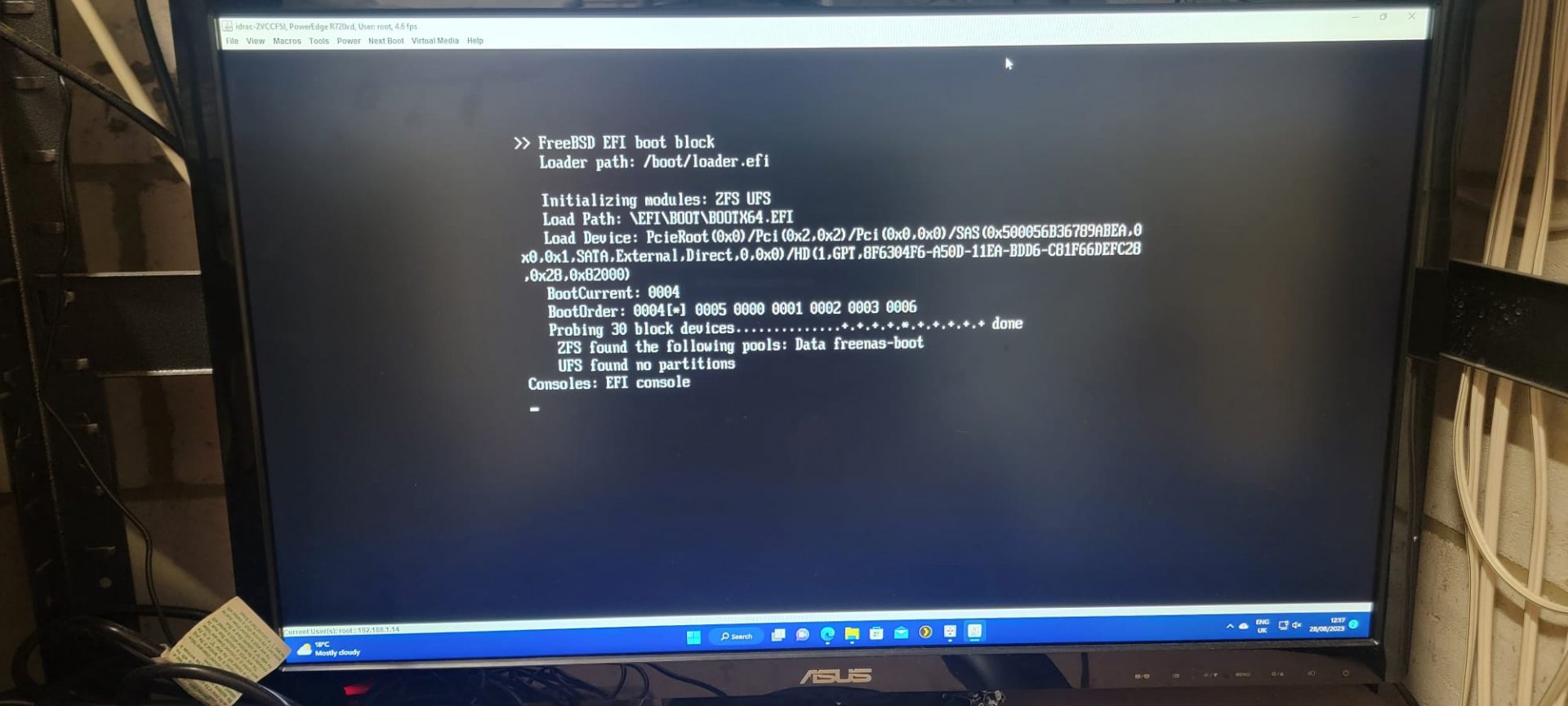

Yesturday my Plex server stopped working so I started to investigate. I notices the mapped drive wasnt working so I restarted my Truenas server. Attached is the issue I got and it is not booting for me to access the Truenas logon screens. I have 2x ssd as a redundancy so I cant believe both SSD have gone faulty.
Its been a very long time since I installed the system. I originally had freenas and then updated it to truenas. I have Old saved config files which were from 02/06/2000 which is when I had freenas on it. Not sure if I have the config files from after I upgraded from freenas to truenas.
Please can someone help and guide me what to do as I really cant remember how I loaded the system as it was a very long time ago.
Thank you in advanced.

Try booting with one or the other SSD disconnected.

YOU ARE A GENIUS!!!!!!
I CANNOT TELL YOU HOW GREATFUL I AM. IT IS WORKING.

Yes have a dell rd720xd however I think it passes all drives to Truenas as in the dell software is doesn't show or report the drives.
I think I remember I had to flash the raid bios for it to talk directly to truenas. This was a long time ago so I might be just talking a load of momo gumbo but I'm sure I did the above.

What do you mean your "raid" can take 12 drives? Are you using a RAID controller / software (beyond ZFS)?
I think Dell R720XD can come with either H310 or H710 controller. The H310 is a regular HBA while the H710 is a RAID controller. Not sure which one OP has.
