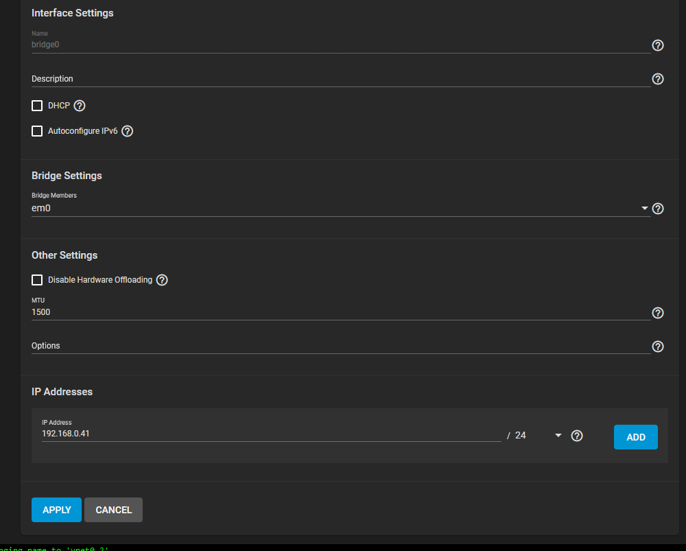

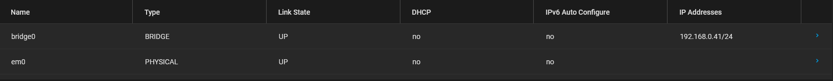

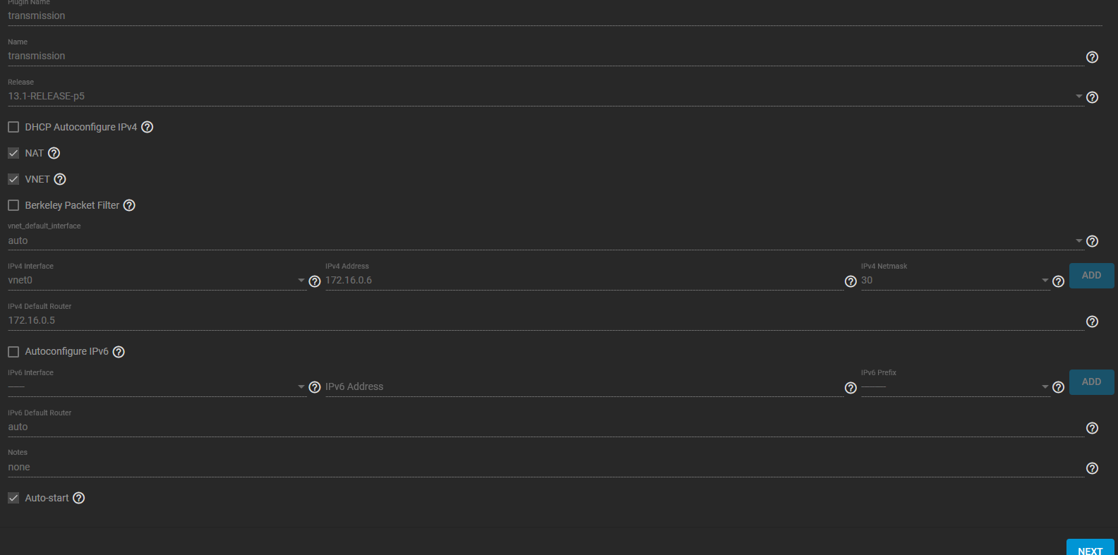

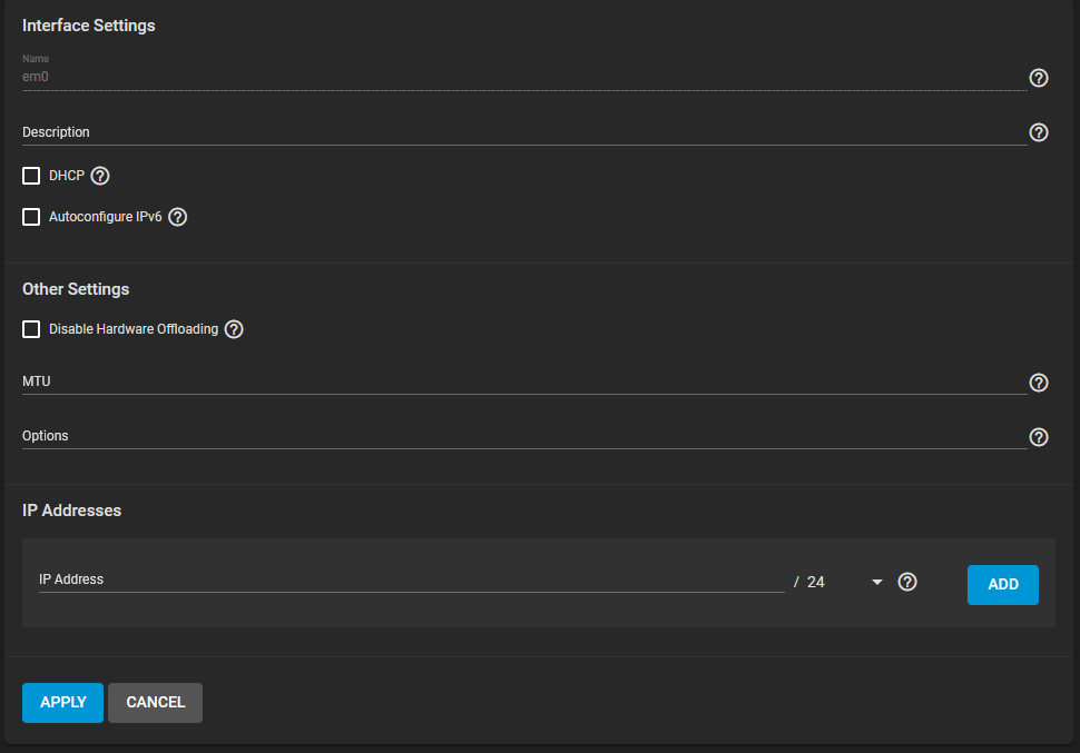

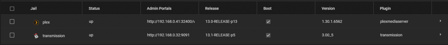

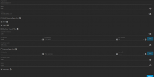

Today is the second when the whole network turned off which means all in the house no internet connection except now wifi, but in the LAN no internet connection in any computer. This is the settings to the bridge and plugins. Am i wrong and i am missconfigured something?
If i restart the NAS server the whole network alive again and able to search anything. It's a bug or i need to configure something? I am not using a proxy service in TrueNas. The truenas logs any errors which cause anything?

9,700
You should have Disable Hardware Offloading ticked on em0.
I don't quite understand how your jails are both VNET and NAT, but if they work I don't see why that would suddenly cause a problem after some time.

The interfaces list shows just em0 and a bridge, so I doubt that.
I ticked the Disable Hardware Offloading already and it's making the anomaly again.

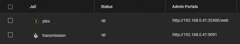

I am disabled NAT in the Transmission jail, now this is are the ip addresses. The Truenas GUI working in 192.168.0.41, but the transmission is working in 192.168.0.32:9091, it's perfect or i am need to change anywhere to 192.168.0.41:9091? If i am enable the NAT there the ip address is 192.168.0.41:9091. Or all of them is perfect? Both of the addresses is working normally. Yesterday stopped working the NAS and the whole network 3 times, but in the night it's working fine. How is it possible? We are using 19 devices, is it possible to someone messing with someone?
And the second thing which i am saw when the Truenas GUI and SMB and plugins stopped working and the network too, when i plug a monitor and a keyboard into the NAS no video input come out and no response from the keyboard, but the fans spinning, HDD spinning.

I turned off the transmission jail/plugin. Today there are no crash so far. It is possible the transmission crash all the Truenas and the whole network? I hope this is the error but if not where should i go?
9,700
I can imagine that this points us at your RAM... 8GB is too little and with transmission running, I guess somehow using more memory over time, eventually uses too much.
How that causes your entire internet to become unavailable I don't know.
Adding RAM would seem to be at least part of the solution.
