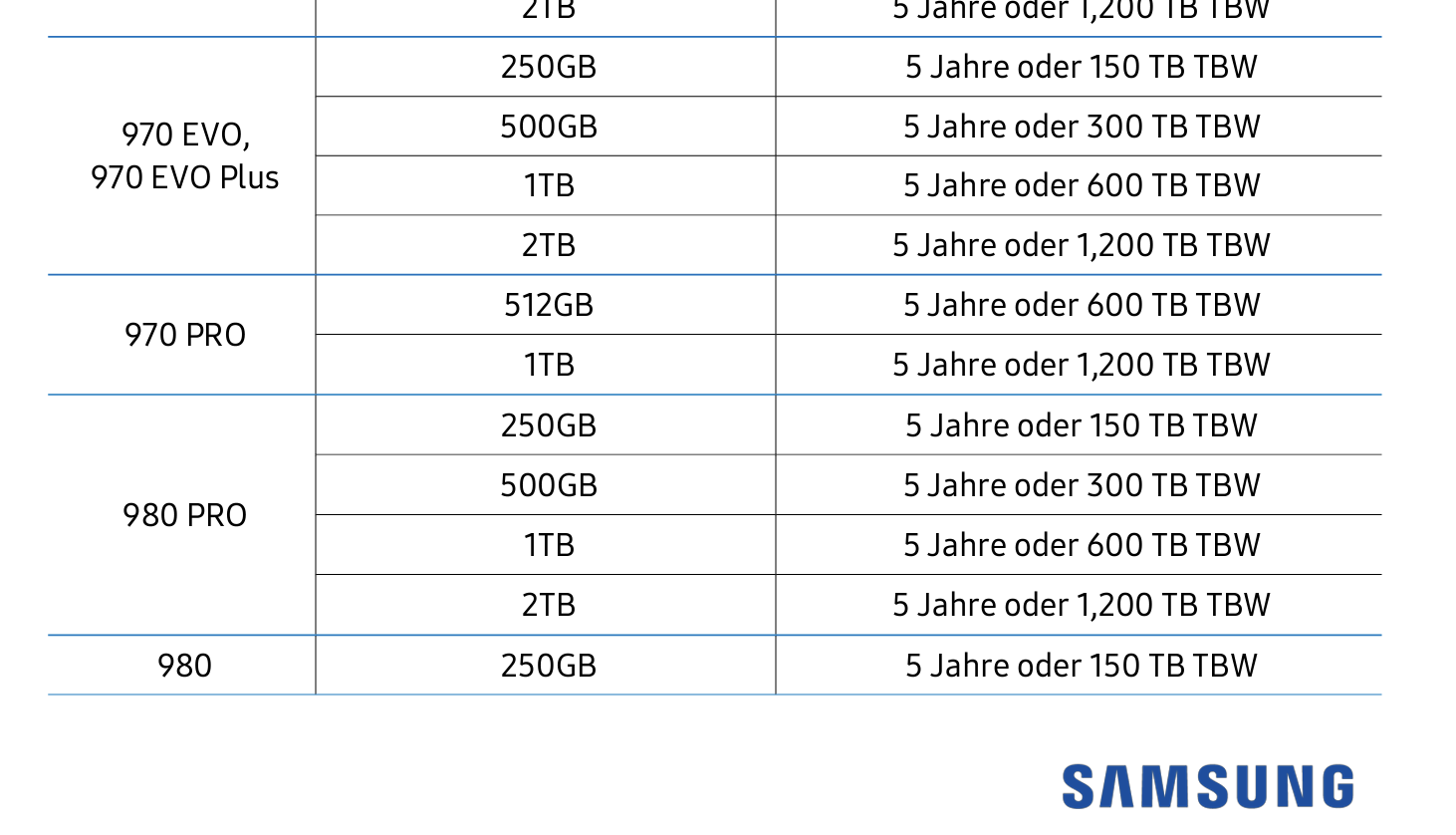

If it's under warranty, file a RMA request.
Its a Samsung SSD 970 EVO with 29131 h => 1213 days of operation, slightly out of warranty.
UPDATE:
found this, looks like the ssd is still under warranty.

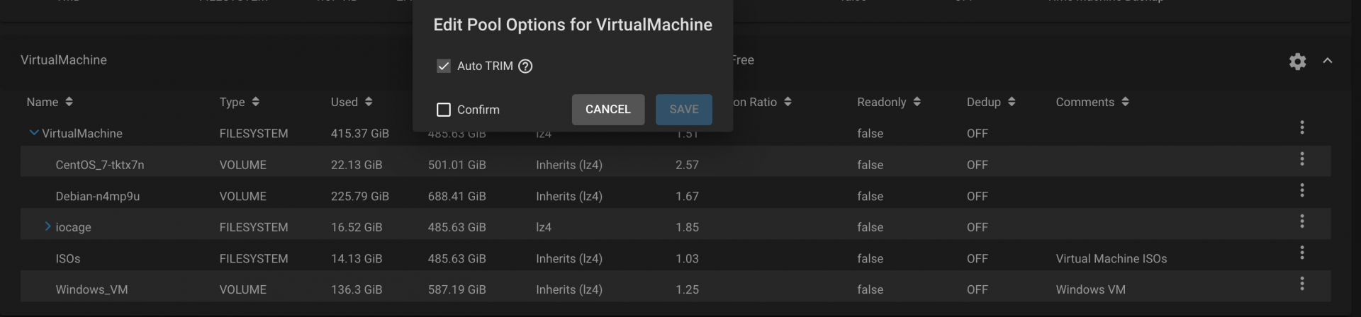

For what it's worth, I disabled "Auto TRIM", but I do have a weekly cron job that issues the "zpool trim" command on this pool. Are you using any form of TRIM (auto, weekly, something else)?
Auto-TRIM is enabled for this drive.
