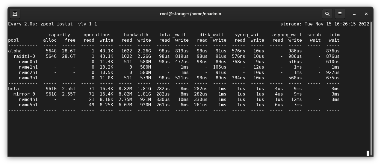

I switched to ubuntu with openzfs, and we've not ran into any disk or checksum errors. Whereas with truenas within first 10min of pushing data to it. Pool A would always give disk write erros, and Pool B would give checksum errors.
I didnt post the logs for burn in as it found nothing, im convinced theres some nvme driver/freebsd stuff going on here with the truenas kernel provided. Im just a network engineer though, idk jack about this stuff, and frankly all the guides here a 1/4" to deep for me to process entirely or are not 1:1 what im doing. maybe im losing something in translation.
My end goal is definitely to use truenas, but im lost on how to proceed. Burn in tests dont make sense for me to keep doing if it works fine on other OS.

Also fwiw, it does appear ubuntu is allowing for faster file transfers as well, I was never able to get over 1.2GB write speeds on truenas. Whereas it appears to have doubled here.
