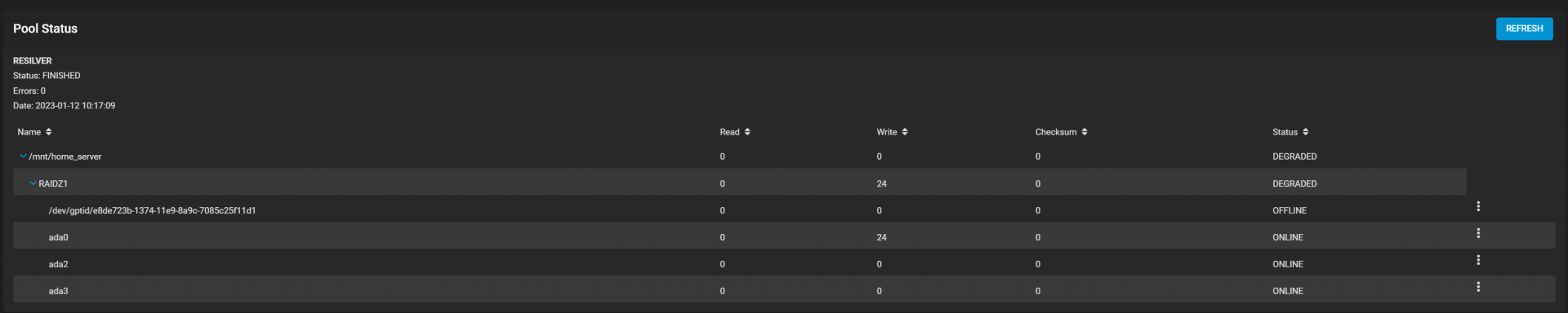

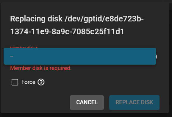

Thanks @sretalla that worked. I removed the disk and replaced it with the new one, however, in the UI, now I don't see it as a member disk:
denis4o
Nov 30, 2019
21
Edit: I shut down the server and the disk showed up. It is resilvering now. I am not sure why the hot-swap didn't work.
