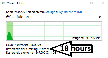

So I have truenas up and running on a machine on my network. On an Asrock J3455-ITX motherboard which has a realtek nic and I'm seeing awful transfer speeds to and from drives on the server. The drive I'm transfering to is a WD40EFRX. Not sure if there are some settings I'm unaware of in truenas that should be enabled or if it could be the nic.
I'm transfering from a windows 10 pc to the nas and getting about 100KB/sec write speeds.
Does it depend on what I'm transfering? Right now I'm trying to transfer my Unity3D projects to my nas so I have a backup of the files just in case.

Three things come to mind as potential culprits:
  • RealTek NIC: See "recommended readings" in my signature
  • Is this drive an SMR model?: Again, recommended readings
  • Your network: How are the machines connected? Built-in switches from router-like gear often suck
Arwen
May 17, 2014
3,611
First off, that is an older board. It uses the slower DDR3 memory and a simple 4 core, 4 thread processor that was launched 8 years ago;
You don't list all your hardware. Having the bare minimum of memory, 8GBs can affect performance. Further, that board only supports up to 16GBs of memory.
Next, the RealTek Ethernet chip will impact performance;
Even adding an Intel Gigabit Ethernet adapter into the only PCIe slot may be problematic as it is only 1x lane, and does not appear to be open ended slot. So any additional PCIe card would have to be a 1x physical, (unless you cut out the end of the slot).
SMB / Samba tends to want faster processors, rather than more processors. So a 2 core, 4 thread higher performance CPU will work better than a 4 core, 4 thread lower performance CPU.
How are your disks configured?
You mention "drive I'm transferring to is a WD40EFRX", which implies single disk pool. That may be suitable for your purpose, but without redundancy, data safety is non-existent.

Before I answer all your questions and concerns I want to add that I just tried transfering a 3.3 GB mp4 file onto my nas using iSCSI and it took 1 or 2 secs at 1.88 GB/sec, so a super fast conclusion could be it's a SMB problem. I'm saying this without any knowledge of how SMB or iSCSI really works. I just looked at the numbers and drew a conclusion.
I'll look into RealTek NIC's also as Arwen pointed out, the board I'm using doesn't have many options with PCIe slots as it only has a 1x lane which could be problematic when trying to find an Intel NIC.
The drive is CMR according to https://www.truenas.com/community/resources/list-of-known-smr-drives.141/
My nas is hooked up via a router, the brand name is AirTies. Not sure if that means anything to any of you.
My nas I using 16 GB of ddr3 1600.
I'm trying to transfer data via SMB so maybe that's the problem, my nas cpu is pretty bad, 4 cores up to 2.3 GHz.
Yes I know there is no redundancy right with just one drive but I wanted to see if it would work at all, before making more advanced drive pools.
While your test with iSCSI seems to invalidate that possibility, that is certainly a setup I would consider "recommended". Any cheap 20 Dollar 1 Gbps 5-port switch from e.g. Netgear will be better. You would certainly not be the first to be bitten with this (and that includes me 15 years back).
Not entirely sure how that is going to work. I have fiber coming into our house then that is being transmitted via wifi to 5 routers/extenders and it's one of these extenders that the nas is plugged into.
So I'm guessing the nas is on wifi.
however that doesn't explain the iSCSI speeds. I took a larger pc game folder and transfered that via iSCSI and the first 5 GB went super fast, something like 800 mb/s then it slowed down to a 10ish mb/s for the last 20 GB of the folder.
Maybe I did something wrong when I setup SMB, should I just use iSCSI instead? I don't know what the practical differences between SMB and iSCSI is. is there a real downside to using iSCSI when only one pc needs access to the files stored?

So I fixed the whole bad SMB transfer speeds situation by simply changing the "Share type" from Generic to SMB, it's an option you get when you create a new dataset. Mine was origionally set to Generic, so yeah reading everything carefully helps ;)
