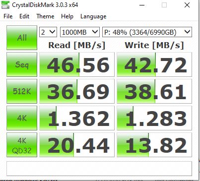

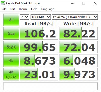

So I moved from a nice house where I could easily run Ethernet cable (any hard line) into a new nice house where I have very few possibilities to run hard lines. This left me in a pickle as the the location I wanted to place my servers and printer and what not had no prewired Ethernet cable. I do have a coax cable so I will look into some sort of converter (one must exist) but it's not a high priority for me as my server is mainly just backup data. Anyway from my main computer to the Router is Cat 5E, from my Router to my computer room is WiFi (Asus RT-AC68W) now as an AP (Media Bridge) and the two are separated by about 20' and two walls made of drywall material (so they are physically very close together) and I have a very good connection in my opinion.
The purpose of this posting is to clearly state that WiFi is NEVER as fast as most people think it is. While I was maxing out my Ethernet throughput on my 1Gbit connection, now I am lucky to get 55MiB/s during a backup operation using SMB protocol (did not test any other). Attached are two tests I performed just to show the comparison between the two and the WiFi connection screen.
WiFi Connection
Ethernet Throughput
WiFi Throughput

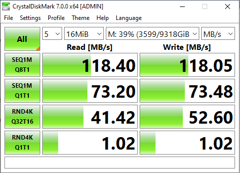

First I'd like to say that the intent of my original posting was to let those many new users know that WiFi is not as fast as they think it is and I tested it out to prove it. I had no idea this would turn into an option for me to use my coax connection to facilitate my network connection, but I'm glad it did.
The results of the throughput test are very good, as good as Ethernet for my use. I'm sure there are some minor latency added in (about 2 to 3 ms according to other folks) but that has no bearing on a home use system.
So installing and configuring was a snap, actually there was absolutely no need to configure them at all but I did change the default IP address from 192.168.254.254 to 192.168.0.253 and 192.168.0.254 so I can log in on my network without re-configuring my Windows Ethernet port to access the device. I plan to monitor it for a few months to see how it's doing, if it's dropping packets or anything. So far over the past 3 hours it has not dropped a single packet.
My throughput testing was just something very simple and my goal here was to check the network speed, not my FreeNAS pool speed so I used the minimum file size in Crystal DiskMark to check it out.
Sorry, I wanted Apples to Apples testing but the FreeNAS server ended up getting a new version update and actually a new VM rebuild so things are not exactly perfect and I'm running through a Router vice a nice fast network switch (need to locate one hiding in a box), and I'm using a newer version of the benchmark software as well.
GoCoax (New Windows Machine Test)
I'm very pleased with the results, with one exception, it was too easy, I didn't have to troubleshoot anything, no bugs, it had no climax. So if you have Coax cable in your home and you would rather not run some good Ethernet Cat 6 cable around, this is a very viable option and as of right now, I highly recommend it. One day I could buy another unit (many if I needed) and put it upstairs but I don't have a need for it right now.
The one thing I also looked into was another product that was also MoCA 2.5 but it had two 1Gbit Ethernet ports and a review showed that both ports could be fully saturated at the same time. I was impressed but the price of those devices was $180 USD for a pair (not sold in singles yet), the GoCoax devices were $60 USD each ($120 USD pair), so a fairly large difference and where I placed the devices, I didn't need two full speed ports. The good thing here is I could add a device like (the two port unit) that to my coax and still use the two ports at full speed, the backbone supports it.
EDIT: I did run iperf (never ran it before) to just have another point of view for throughput, iperf3 running as server on FreeNAS shell, iperf3 client running on Windows 10 machine, had to run at least 4 streams to get these results, and the results are:
[SUM]   0.00-15.00  sec  1.61 GBytes   924 Mbits/sec                  sender
[SUM]   0.00-15.00  sec  1.61 GBytes   924 Mbits/sec                  receiver
