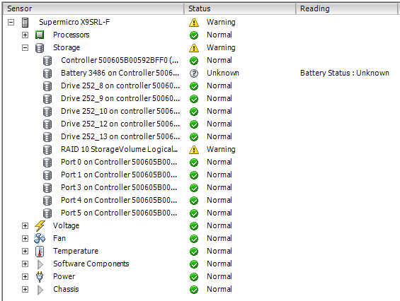

In a mean time I have another idea: How about if you install only the driver for showing the raid health (lsi provider) and for full management use the Windows software from inside a VM ?
P.S. I pull a drive on my raid aray to see if health will change in ESXI storage and indeed it does. So if there is a problem it will shown in the vsphere "storage" so future action can be taken.

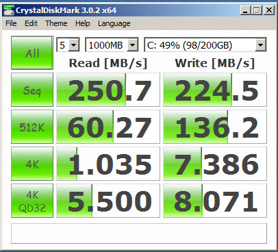

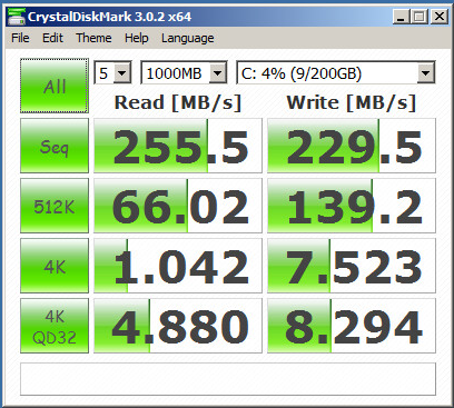

Finally I got the time to put my theory to the test, and I can't wait to share the great news:
Remember the idea was from fresh esxi install to install only the "lsiprovider" driver, but not the megaraid driver, or anything else. Because when I install both drivers, write speed drops to 80-90MB/s from being over 200MB/s without any drivers.
And here is before and after results. I am so happy with the results. Now Esxi will monitor the card health and in the same time , performance is not affected. And I did check the write performance with actual 100GB of data copied over the network to the VM , so it's not just a synthetic benchmark, it can sustain sequential 210MB/s write.

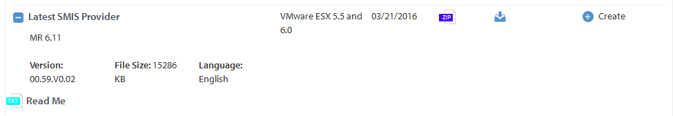

Well that is great news! Could you please specify exactly which lsiprovider file you used? I will likely try this out this weekend. For me I will need to uninstall the UPSMON driver and then install the lsiprovider, I could use the override but I would rather be overly cautious.
Thanks for the great work.
Nov 11, 2014
1,174
I used the latest driver from LSI web site. See pic.
