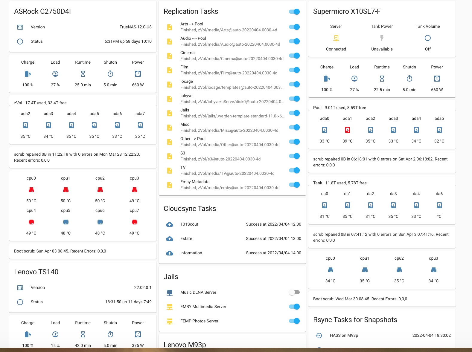

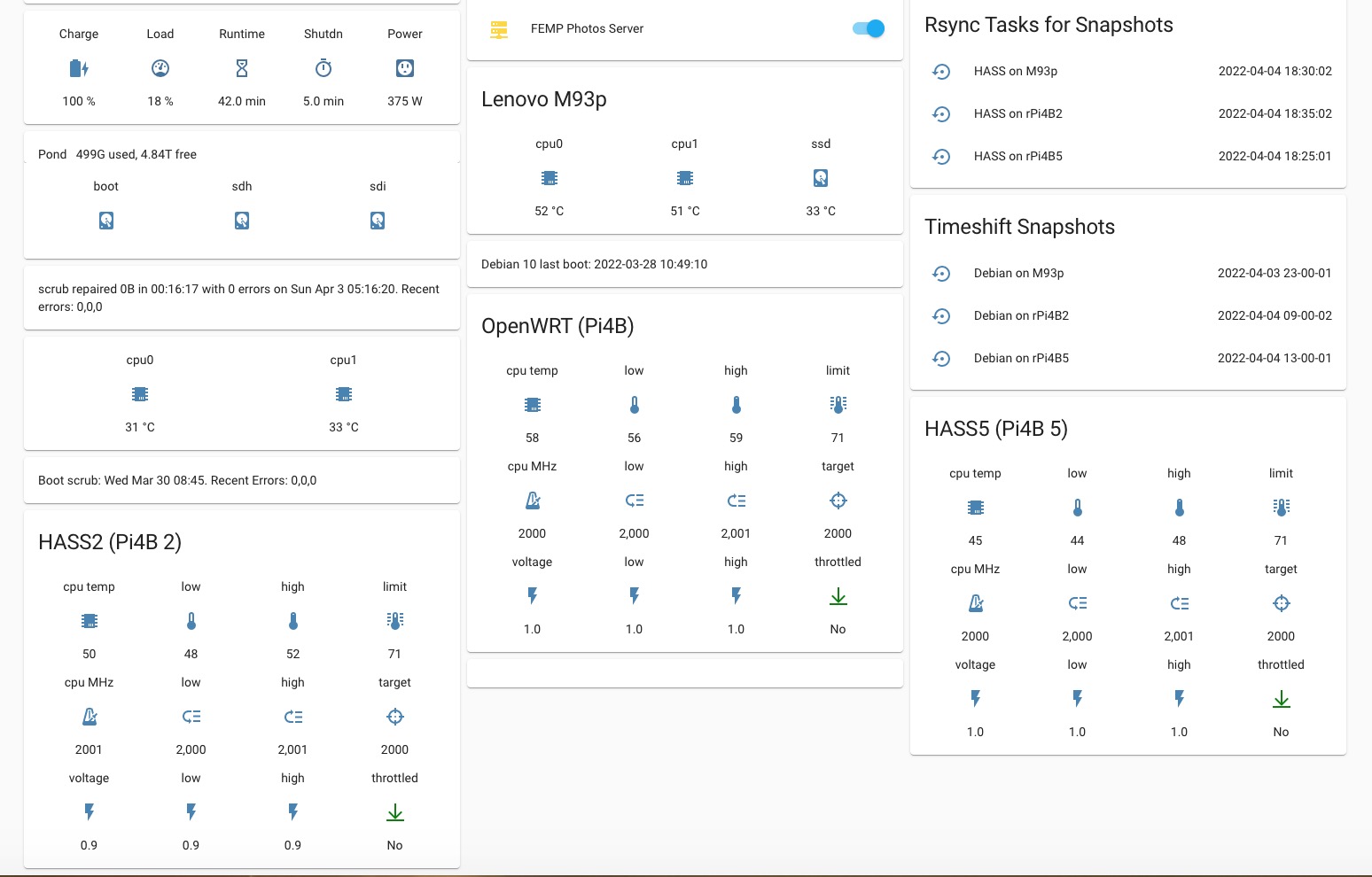

Hey joeschmuck.
I'm thinking some processor and memory information. Then I think staple my tongue.
Ever seen my HomeAssistant Servers page?

Hey joeschmuck.
Looks like a good project for you, looking at those screen shots you have the skills. The only work I plan to do right now is if someone reports the script is not working for them then I will try to fix it. I am in progress of rewriting the entire script because I dislike having a lot of processing within the AWK section, I want to pull that out. This will make it easier to segment the sections and I also think the few issues with specific hard drive serial number recognition may go away as is well. But this is a project that will take me maybe months to complete as summer is here and that means being outside more, not stuck inside the house, except when we have thunderstorms. And of course I have my day job where I don't get time to work on the script.
Now to humor you... What data points for the Processor and Memory information do you plan to take? In other words, what snapshot in time are you sampling? Taking a snapshot only while the script is running does not seem useful, well maybe the memory could be. I have not researched it to see if you could get the data from the command line, which is what you would need to do. Maybe collect the Min/Max/Ave of each over the previous 24 hours? Is that possible? That is the only useful information I would desire, if I were collecting data that is. If you desired yo could create a script to collect that data and place it in a CSV file periodically and then email it at a defined periodicity. I think you can get the memory and maybe the cpu data, but will it be over the past running 24 hours? I don't know. While I want to look into it, I will hold off since I'm at work right now.
Have fun with your new project.
TooMuchData
Jan 4, 2015
188
Definitely staple my tongue.

TooMuchData
Jan 4, 2015
188
I sent you email offline about the home-assistant displays (didn't want to cludge up this conversation). In addition to sensors, etc. home-assistant allows for statistics to be tracked on any already defined entity (sensor) at various intervals.
For the purposes of multi_report, I suggest only a snapshot at the moment the script is run of cpu busy and temp, etc (that kind of simple stuff available via ssh commands). Maybe fan rpm (why?). ;-}
Anyone who wants serious tracking and realtime analysis should install the Netdata plugin. Does it have an API?
