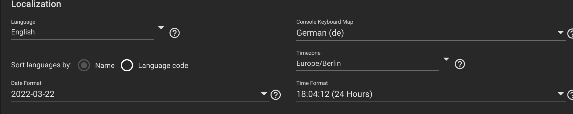

Interesting. Out of curiosity, did you change anything like the date format of the system and language? Anything which might change the way the system handles date/time functions? I'm not sure why that would cause this, I would expect the date function to just work properly regardless. i do not recall using the underscore in the date section. And while it looks like you are running TrueNAS 12.0-U8 (Core), I do want to verify you are running Core. The date function quoted above is for Core and I would hate it if the code failed to recognize you were really running Scale.
I can't recall if I've ever changed the date and time settings, but here there are:
And can confirm I'm running core 12.0 U8. If I can be of any further help, let me know.
I will give this a try on my system sometime this week to see what happens. If there is a fix, hopefully it can be made easily.

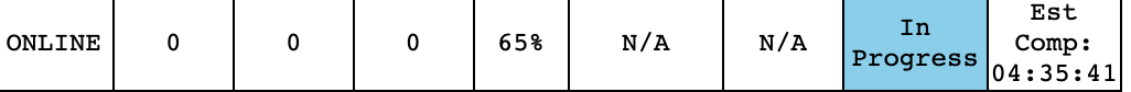

Tried out the new version, works pretty well except:
line 727: [: too many arguments
That would be:
if [ $scrubDays == "days" ]; then
   scrubextra="$(echo "$statusOutput" | grep "scan" | awk '{print $6}')"
extra info: there is a scrub in progress right now. Seems the script detects it correct.
That would be:
extra info: there is a scrub in progress right now. Seems the script detects it correct. View attachment 54387
So I never got that error when I ran it but that doesn't mean anything. I'm at work right now but you have my email address I believe. Send me a copy of your script as-is. Let me run it on my system to see if it works. Hopefully the issue is obvious. There is definitely not too many arguments on that IF statement. And i'm assuming that you are still running on TrueNAS 12.0-U8 for this issue.

Ok, so here we are again. Scrub is running on mainpool and the script is finishing with the exact same error.
/mnt/mainpool/scripts/Multi_Report_Script/run_multi_report.sh: line 727: [: too many arguments
 pool: mainpool
 state: ONLINE
  scan: scrub in progress since Wed Mar 30 22:40:37 2022
        3.31T scanned at 740M/s, 1.48T issued at 330M/s, 14.3T total
        0B repaired, 10.33% done, 11:18:01 to go
config:
        mainpool                                   ONLINE       0     0     0
          raidz2-0                                      ONLINE       0     0     0
            gptid/086f0ce8-519b-11ea-84c9-002590472e07  ONLINE       0     0     0
            gptid/08e989a1-519b-11ea-84c9-002590472e07  ONLINE       0     0     0
            gptid/08b1b7be-519b-11ea-84c9-002590472e07  ONLINE       0     0     0
            gptid/08cd2b7c-519b-11ea-84c9-002590472e07  ONLINE       0     0     0
            gptid/b75a7f3c-8267-11ea-8342-0cc47a05eaa0  ONLINE       0     0     0
            gptid/090df988-519b-11ea-84c9-002590472e07  ONLINE       0     0     0
errors: No known data errors
