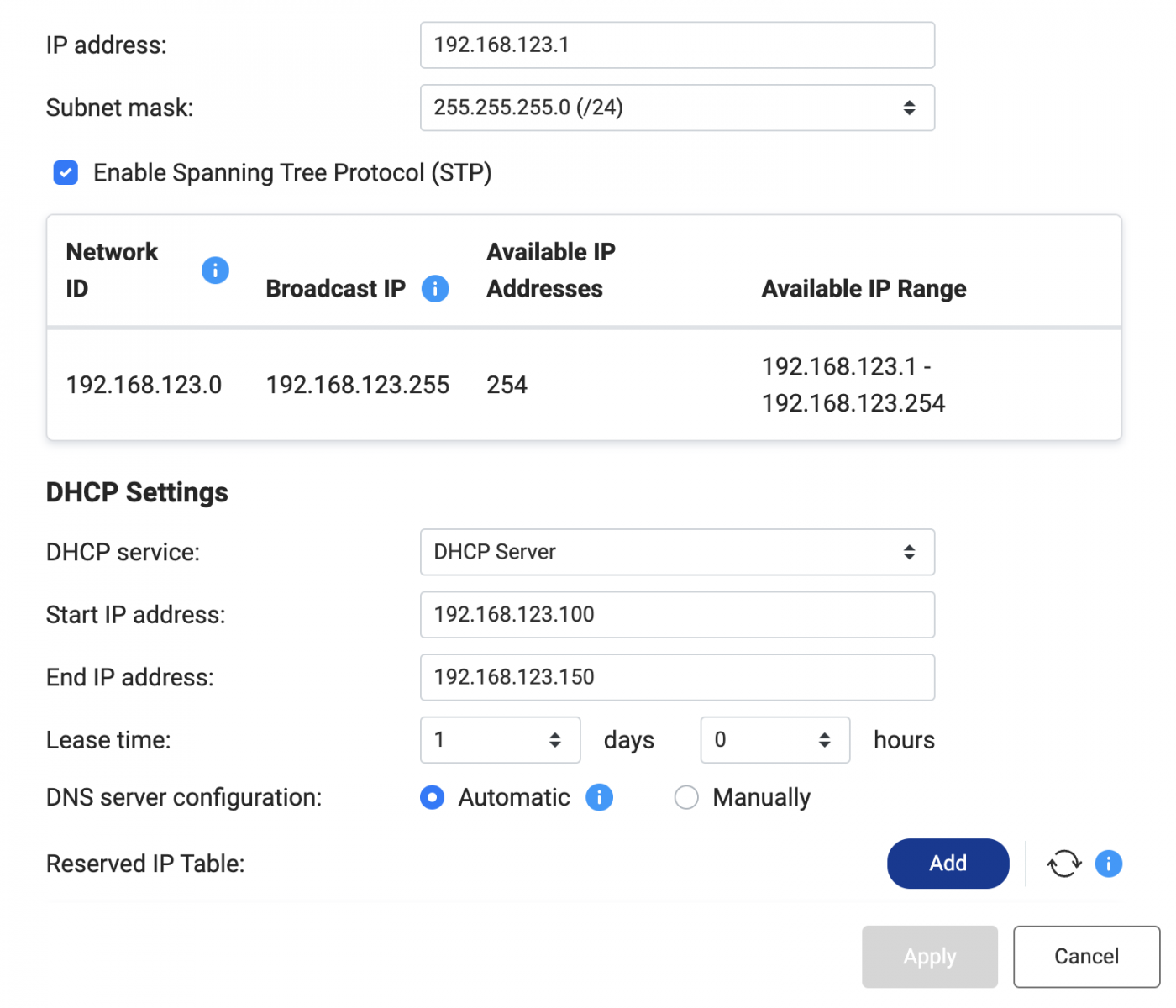

I see, thank you. Right now I am trying to setup it with a bridge enabled on the router:

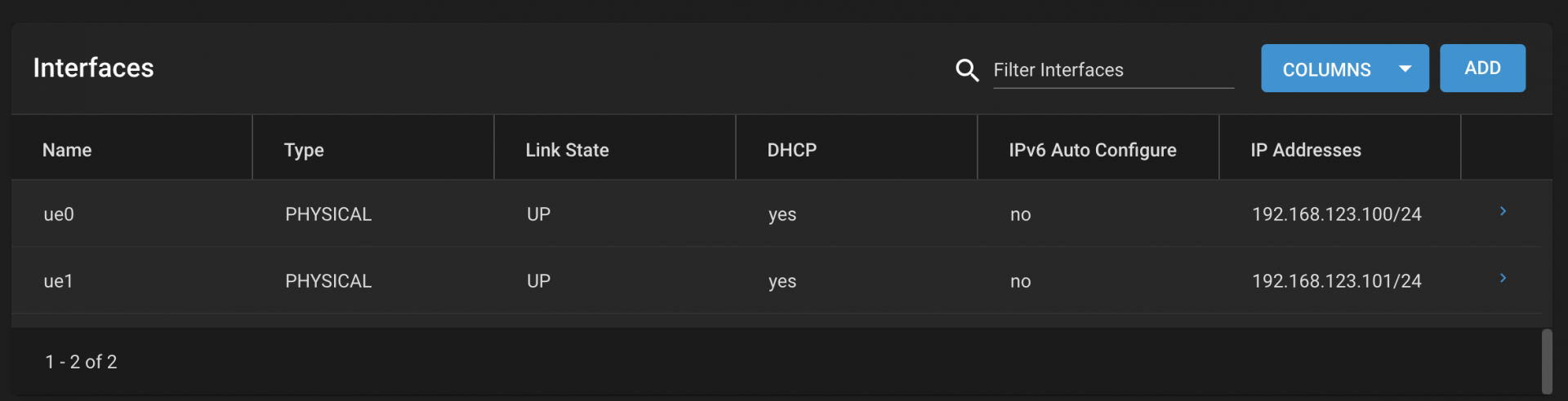

And here is what I have right after reset to defaults on truenas:
Could you please tell me if it is possible to enable load balancing here and in what order and what manipulations I need to perform with these interfaces?

Click Add
Interface Type: Link Aggregation
DHCP: enabled
Protocol: Loadbalance
Choose both physical interfaces (ue0 & ue1)
Save
Test changes
Apply if successful
If testing fails and you can't reach the GUI then don't worry. TrueNAS will revert the changes within a minute or so.

You cannot have two interfaces with IP addresses in the same /24.
You should not use USB Ethernet.
