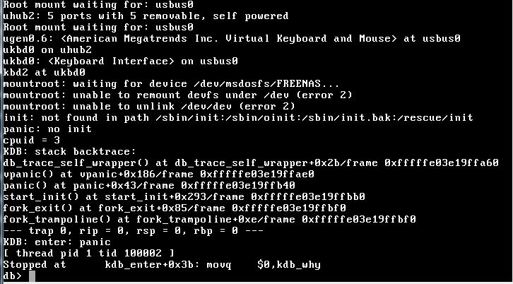

Yea, I was able to setup IPMI but now I'm getting the following error when trying to install freenas.
Stopped at kdb_enter+0x3b: movq $0,kdb_why
Here is a full screenshot of the error
Is this the same error that you were getting when trying to boot from the USB boot media using the USB hub?
Are you still using that USB media or did you remotely mount the ISO file for the installer through IPMI?

No, not using the usb hub anymore, I figured out how to use IPMI so just using 2 usbs directly connected on the motherboard.
- installation files
- fat32 formatted and ready to receive the os installation
15,504
If you figured out how to use IMPI even better, you'd realize you didn't need the USB with the installer, because you could mount the ISO via IPMI as well (after verifying its checksum to make sure it isn't damaged in some way). And that might be a good thing to try--I haven't seen that specific error before, but it could indicate a corrupted installer image.
