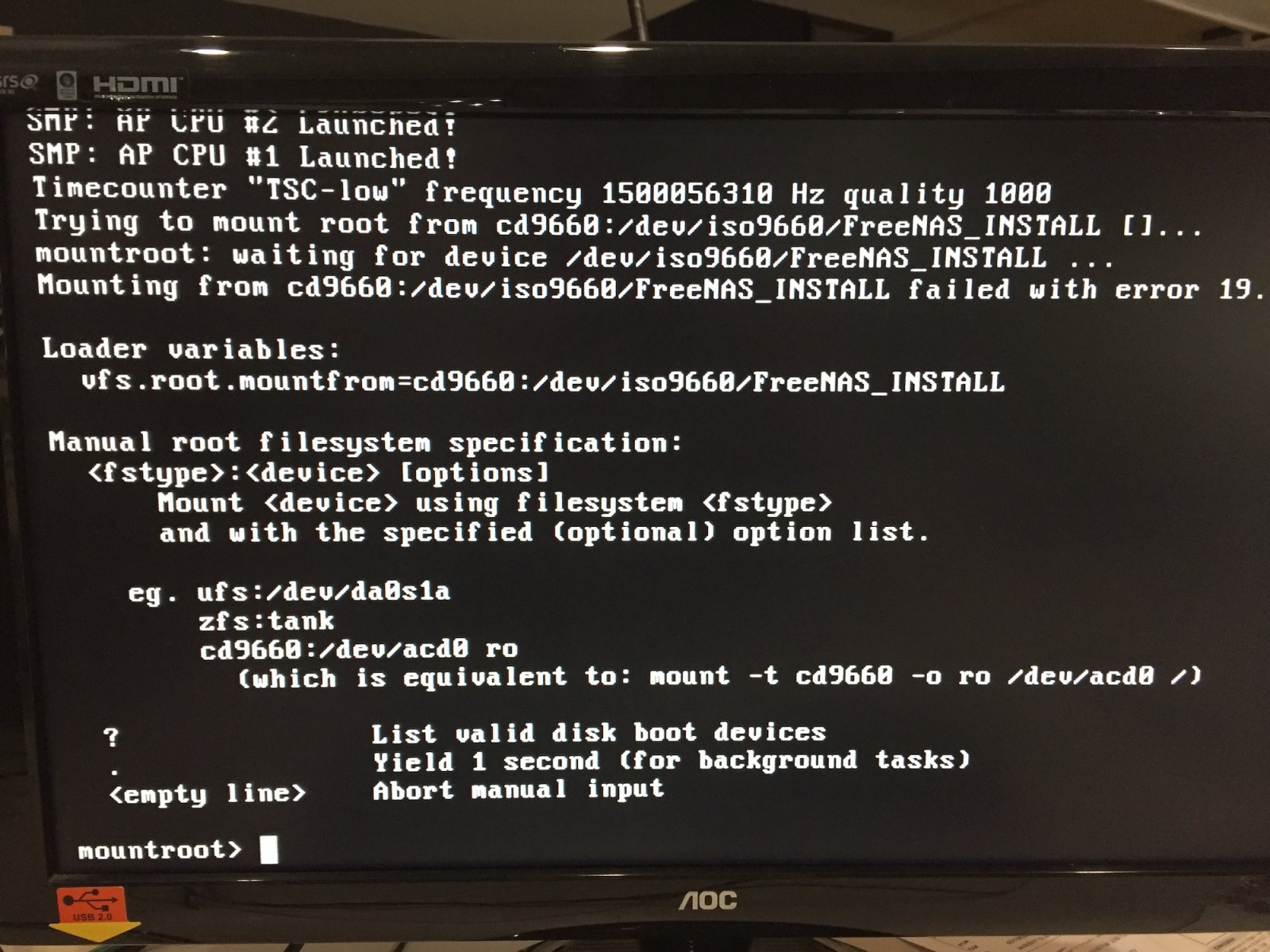

Ok so I've just updated the BIOS to 2.0a and I still have the same issue. I've attached a pic of the screen.
Here my exact steps:
-Insert USB with FreeNAS 11 iso
-Turn on server
-Wait for supermicro logo on white background
-press f11 to boot from BIOS boot list
-select "freeNas 11 installer"
-Error 19
Am I doing something wrong? as I said this is my first FreeNAS install so it could be something really stupid...

I think I might try a different brand of thumb drive. What you're seeing is that the kernel was loaded, and booted, but then when it went to go mount the root device, it couldn't find it. If the thumb drive is not supported by FreeBSD (and there are some that aren't), that might result in that behaviour.
You did not say what kind of thumb drive it was.
