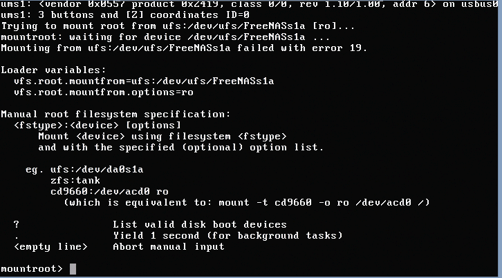

Now to find out whether this prevents this as well:
Edit2: I am not alone:p http://forums.freenas.org/index.php?threads/mounting-failed-with-error-19.13620/
Edit 3 - Solved - Turn off all USB3/ehci/xhci settings in Bios, use the USB2 Ports and use a magic USB stick.
