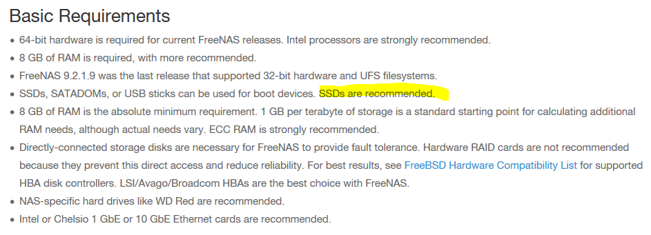

Hardware Requirements
http://www.freenas.org/hardware-requirements/

I understand your recomendation for SSD, though the freenas-boot is also good with USB mirrored. I cannot return a hardwere when it is just remaining hardware from my old desktop.
I have a small server only for storing photos. Performance is ok.
The issue is the ECC on the hardware or everything?
My question still, is usb going to be more reliable, is it something due to FreeBSD11.2 or FreeNas specific?
