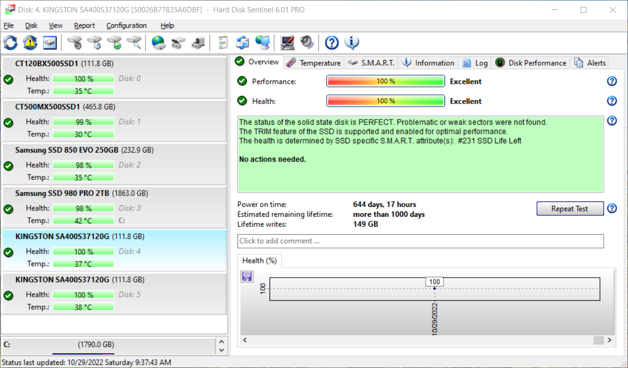

I'm telling you. I did a simple proper shutdown from the TrueNAS web interface like I did many times in the past. This time around while machine was off and I was not home ghosts came over to kill both boot SSD drives where now they show up in windows as unallocated. I downloaded the free Minitool Partition Wizard and looked at the drives in a SATA/USB dock. Both show as unallocated. Initially 2 years ago during my original TrueNAS install I did a lot of research and was recommended that for boot I should have 2 SSDs in a RAID 1 pool for redundancy so this is what I did. And now neither of them boots separately with only 1 of them attached to the TrueNAS machine at a time. Minitool Partition wizard shows that there is a recoverable efi partition.

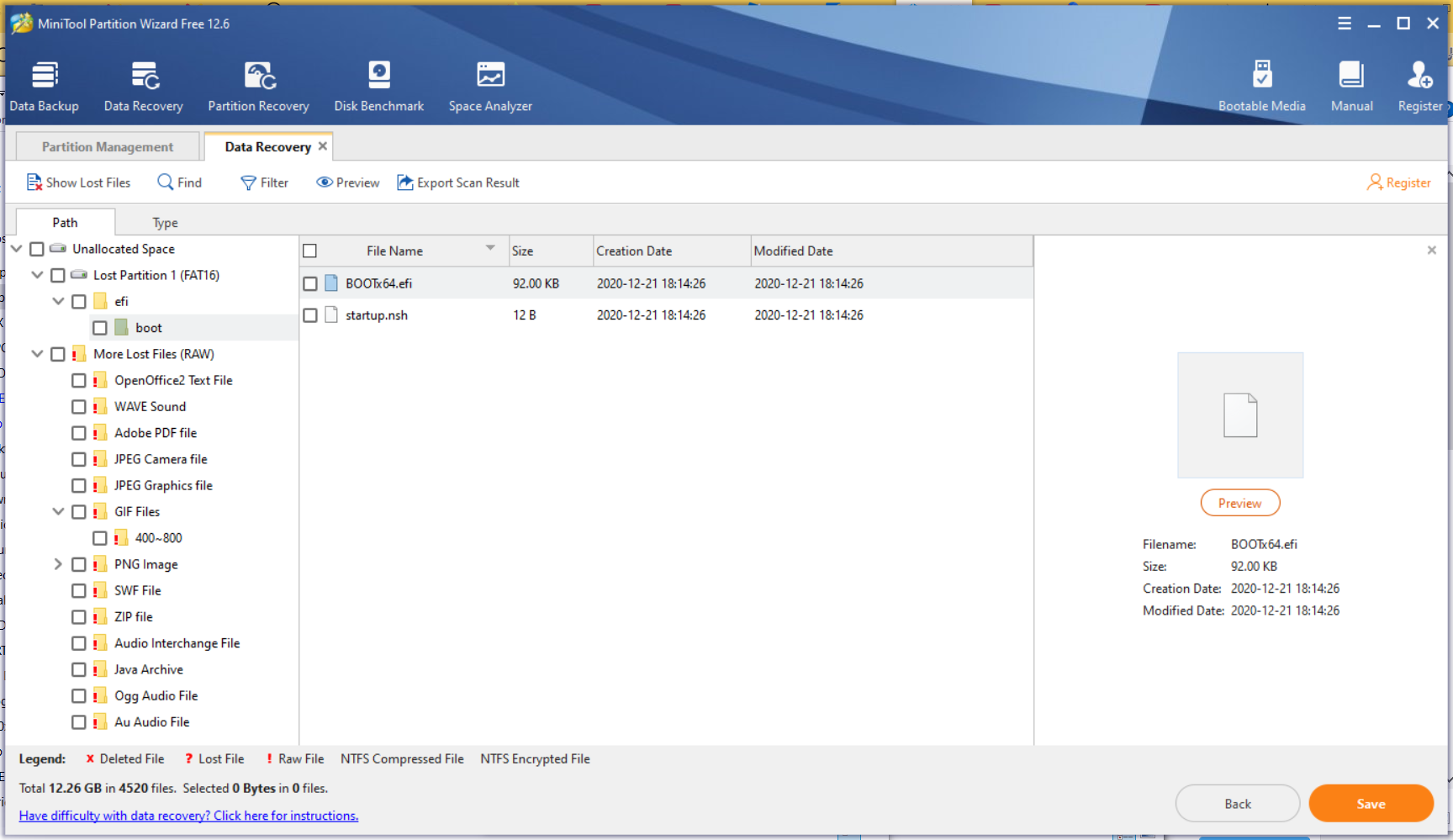

Here are some screenshots how the 2 boot SSDs look in couple windows softwares I have:
Disregard the drives other than the Kingstons which are 120GB. The others are part of my pc I'm using to type on this forum and for testing of these drives.
First 2 pictures show each Kingston as having 100% healthy state according to SMART data
Last picture is from Minitool Partition Wizard (disk 5 and 6)

I saw your postings and have no idea why the drives wouldn't have any partition data, but then again I have not looked at a boot drive with MiniTool Partition Wizard (I use it too). Could be a Halloween curse.

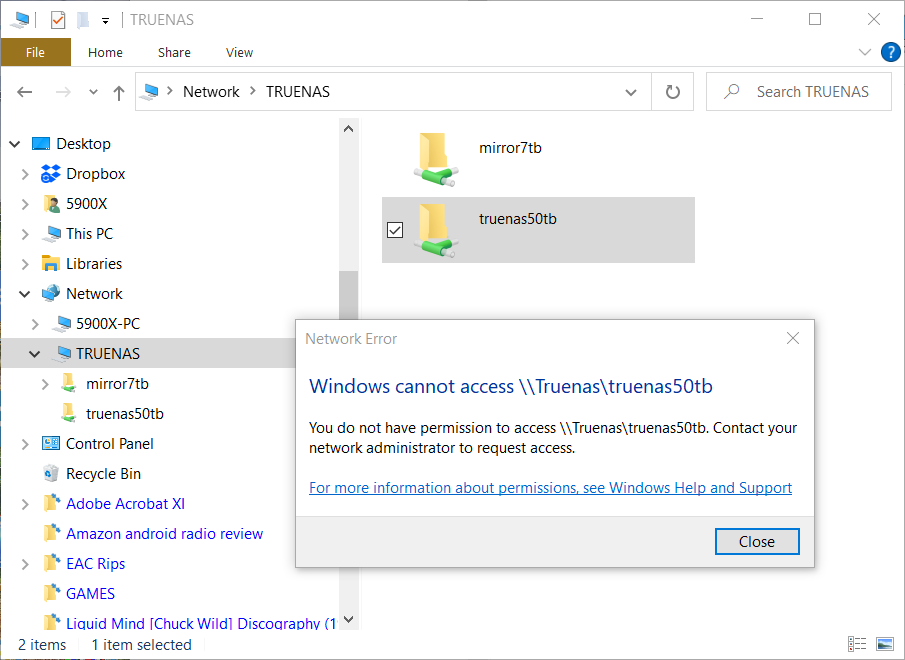

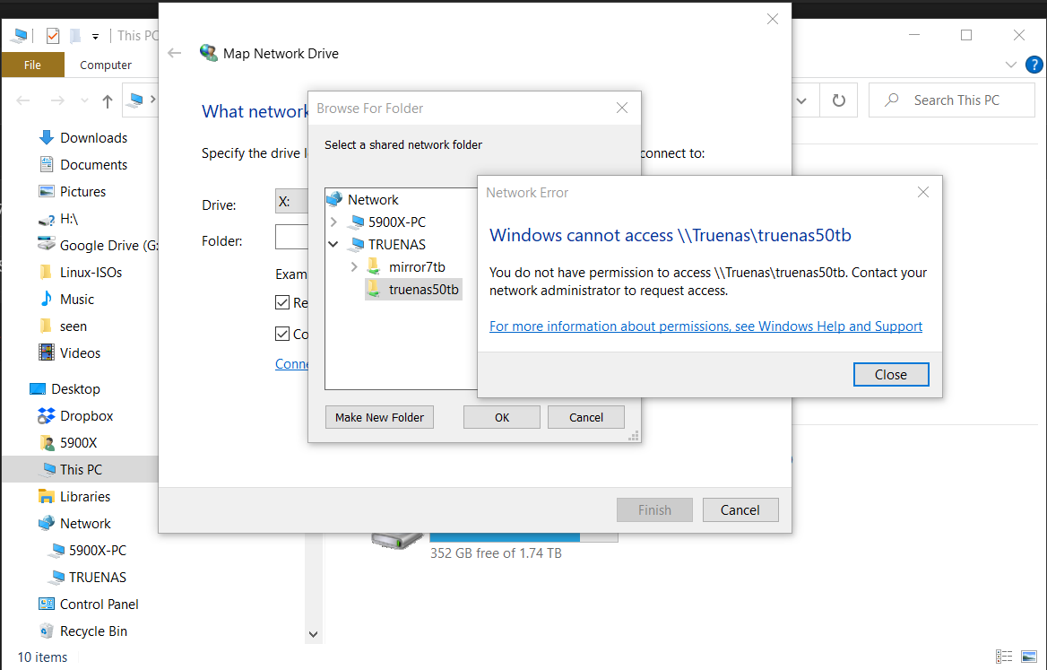

I have installed latest TrueNAS on another single SSD and confirmed with my M1 Mac Mini that data pools are fine. I am having a major problem getting access to the pools on my Windows 10 computer. I had all the info for the pool username and passwords saved and when I reinstalled on the single SSD everything was working on the Mac Mini without me changing anything. Any ideas why Mac works and windows is telling me to remove all the shares before I can make new ones? I am typing this post on the Mac as I was able to test the 2 pools I have and working. I have no clue how to remove the 2 shares for the 2 pools in windows. I did right click on the 2 mapped drives for the 2 pools and disconnected but that did not do anything as now I am unable to recreate the same 2 mapped drives as windows is telling me to contact your network administrator. Mac didn't ask for any of that.
joeschmuck
Old Man
May 28, 2011
10,994
Because Windoze is a PITA? I take it that you did not restore your TrueNAS configuration file and just created TrueNAS from scratch again?

I have no partitions visible on both boot SSDs according to Minitool Partition Wizard so I don't know how else to get the configuration file.
