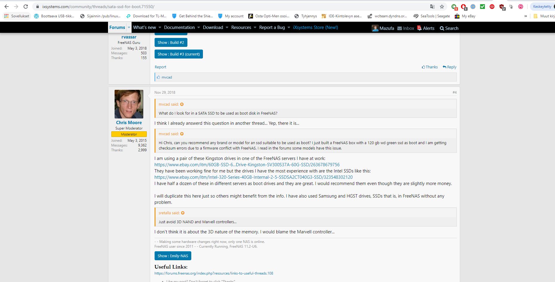

Then could this Intel 320series SSD be good: https://www.ebay.com/sch/i.html?_fr...1313&_nkw=Intel+320+Series+40GB,Internal,2.5" 28SSDSA2BT040G3% + 29% + SSD = 0 & _sacat
This article was recommended this and I'm really impressed. My choice is this Intel320 Series SSD! :)
A forum user said he has had a lot of use of FreeNAS and never had a problem. I would trust this Intel 320SSD if he spoke true.
ixsystems forum ticket: https://www.ixsystems.com/community/threads/sata-ssd-for-boot.71550/
Ebay buy link: https://www.ebay.com/p/219385620?iid=323548302120
Ebay Intel 320SSD buy all link: https://www.ebay.com/sch/i.html?_fr...GB,Internal,2.5"+(SSDSA2BT040G3)+SSD&_sacat=0

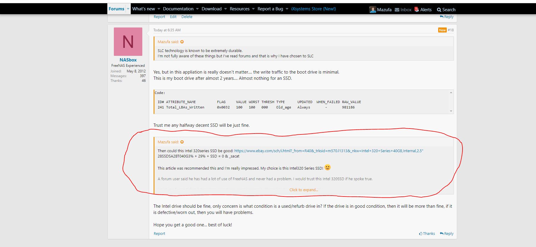

SLC technology is known to be extremely durable.
I'm not fully aware of these things but I've read forums and that is why I have chosen to SLC
Yes, but in this appliation is really doesn't matter.... the write traffic to the boot drive is minimal.
This is my boot drive after almost 2 years.... Almost nothing for an SSD.
241 Total_LBAs_Written      0x0032   100   100   000    Old_age   Always       -       981186
Trust me any halfway decent SSD will be just fine.
Then could this Intel 320series SSD be good: https://www.ebay.com/sch/i.html?_from=R40&_trksid=m570.l1313&_nkw=Intel+320+Series+40GB,Internal,2.5" 28SSDSA2BT040G3% + 29% + SSD = 0 & _sacat
Ebay Intel 320SSD buy all link: https://www.ebay.com/sch/i.html?_from=R40&_trksid=m570.l1313&_nkw=Intel+320+Series+40GB,Internal,2.5"+(SSDSA2BT040G3)+SSD&_sacat=0
The Intel drive should be fine, only concern is what condition is a used/refurb drive in? If the drive is in good condition, then it will be more than fine, if it is defective/worn out, then you will have problems.
Hope you get a good one... best of luck!
