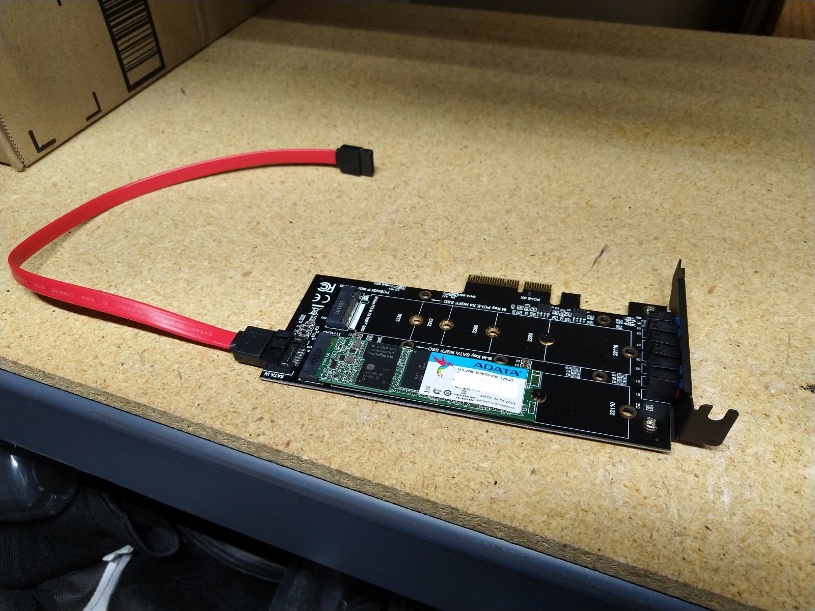

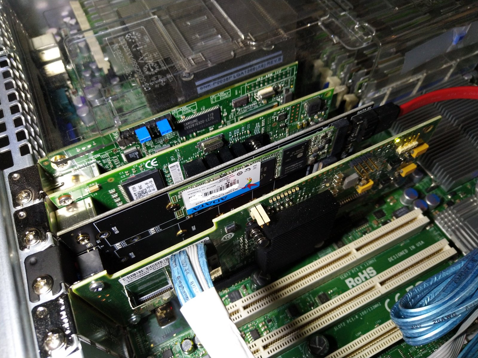

I just installed these components shown below in my Supermicro server the other day to replace the USB boot drive I had. Installation and setup was a breeze and my system is running great so far.
PCIe M.2 Adapter card
M.2 128GB SSD drive
