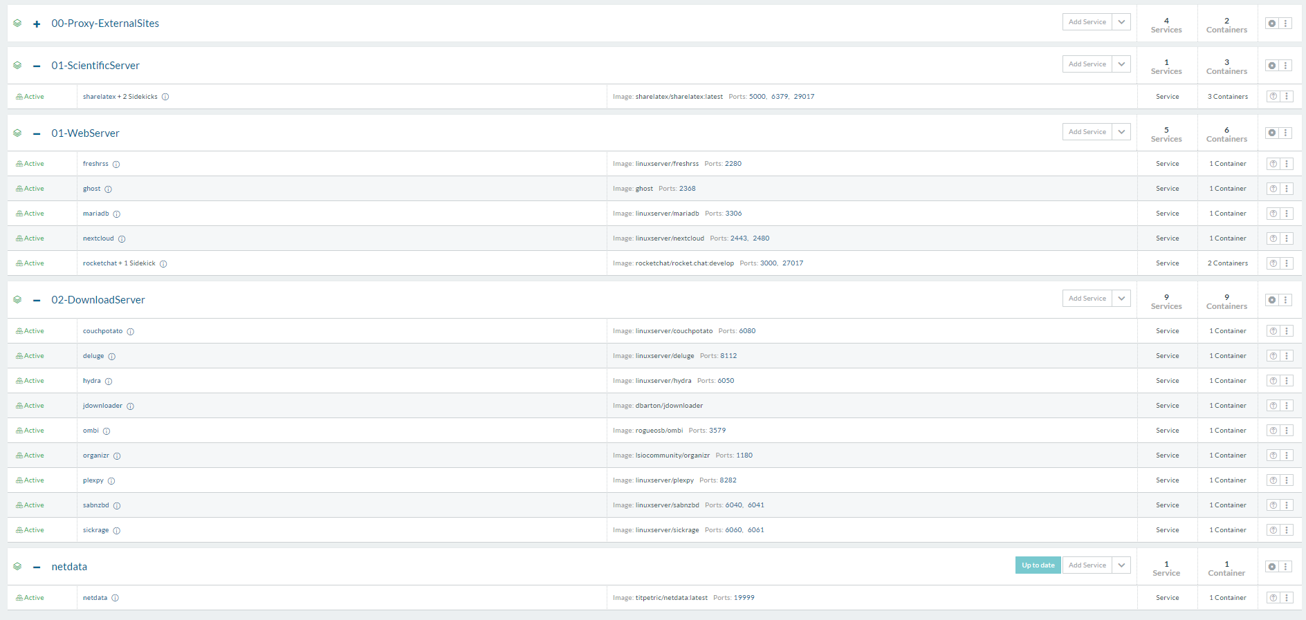

There are some containers where you have to use certain things, plex for example has to have advertise-ip set as an environmental variable, and must run in host networking or so. You'll have to check in the plex container documents on hub.docker.com, or Google how it is being deployed.
But the majority of docker containers absolutely don't need it. Just check my image from earlier. I have plenty of containers deployed. Just by the port exposure.

I tried, shipyard, portrainer, and rancher (RancherOS' GUI) and i stuck with rancher, mainly due to the ability to import and export docker-compose.yml files, that you can edit in an editor. Here is an example for my Webserver Stack (compilation of containers)
my general mounting structure:
host shares:	------   iohyve:RancherOS  ----- inside the container
@192.168.0.2			 @192.168.0.16
/mnt/zpool/docker	   /mnt/docker			 :volumes in docker-compose.yml
/mnt/zpool/dbs		  /mnt/dbs
/mnt/zpool/data		 /mnt/data
Docker-compose.yml

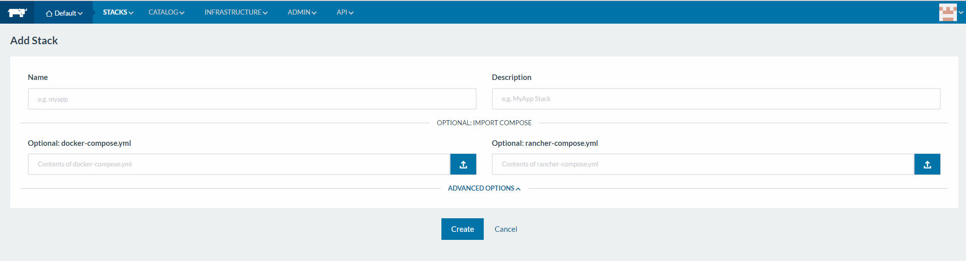

you basically import both files with the gui here:
and within 2 minutes you have
a mysqldb up nextcloud 12 an rss reader and a ghost blog. And if you want to change something for a container you can do this on the fly via the webinterface as well, pseudo realtime editing.
