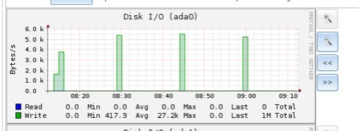

i have set up OwnCloud a long time ago, and every thing runs smooth. The OwnCloud installation is on a another harddrive than my data. Until now i was able to spin down my data drives. But now OwnCloud prevent the spin down of the drives by the cron job i think. Every 15 min. i can see a little access in the report screen for the drives inside freenas gui (see screenshot attached).
Does anyone know what data will be writen from the cron job of OwnCloud to the data drives and how i can fix this issue?
Im running FreeNAS-9.10.1 (d989edd) and owncloud 9.1.0 (stable)
Thanks for any reply and for your help
Arga

I know things like the news app, and periodic notifications are handled then. Even if it's not writting anything, and just reading stuff your drives would probably spin up.
You might want to ask on the owncloud forum.

Hi Joshua,
I think the problem will be the logfile. It is actually written inside the data directory. Can you tell me how I can move this logfile to another place please. I have made this change inside the /config/config.php file:
'logfile' => '/var/log/owncloud.log',
but when I go to /var/log/ there is no ownlcoud.log.
I have made the installation like your tutorial over a year ago. Can you help please?
Joshua Parker Ruehlig
Dec 5, 2011
5,949
Hi Joshua,
you could probably create a logfile writable by 'www' like so.
install -o www /dev/null /var/log/owncloud.log
