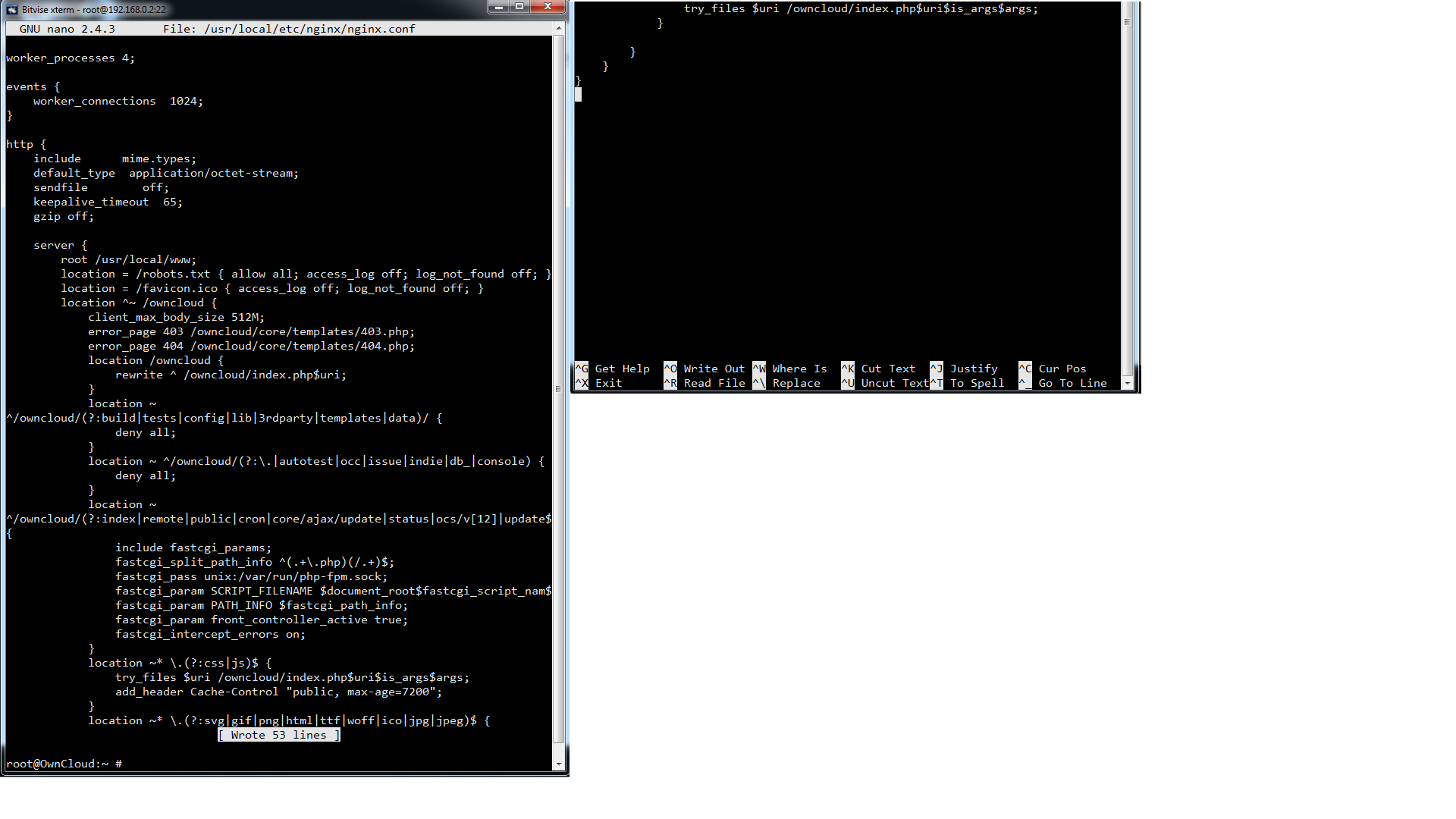

Hi again, thanks for the quick reply, I redid the whole thing, using only 1 jail with both directories. And now it says
502 Bad Gateway
nginx/1.8.1
when i log into the owncloud. I have no idea what is going on, I followed all the steps and still nothing. Please help, I really want this feature in my FreeNAS server.
Joshua Parker Ruehlig
Dec 5, 2011
5,949
502 Bad Gateway
nginx/1.8.1
can you post a screenshot of your nginx.conf

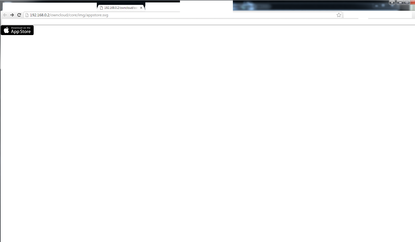

also what happens when you browse to the url?
http://JAIL_IP/owncloud/core/img/appstore.svg

nginx file: When I goto http://192.168.1.14/owncloud/core/img/appstore.svg I get the "download on the AppStore" icon.

rodofrn
Apr 13, 2016
180
Hello, this are the screenshots.
Dec 5, 2011
5,949
your nginx config has some errors. looks like some lines got wrapped when you pasted them into putty.
Then, once you fix the config reload nginx.
service nginx reload

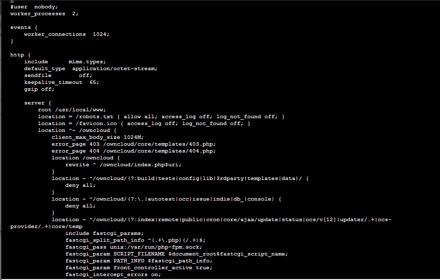

I specifically wanted a screenshot, not just paste the same thing I had pasted.
the icon showing means your nginx config is at least partly working. what's the output of 'sockstat'

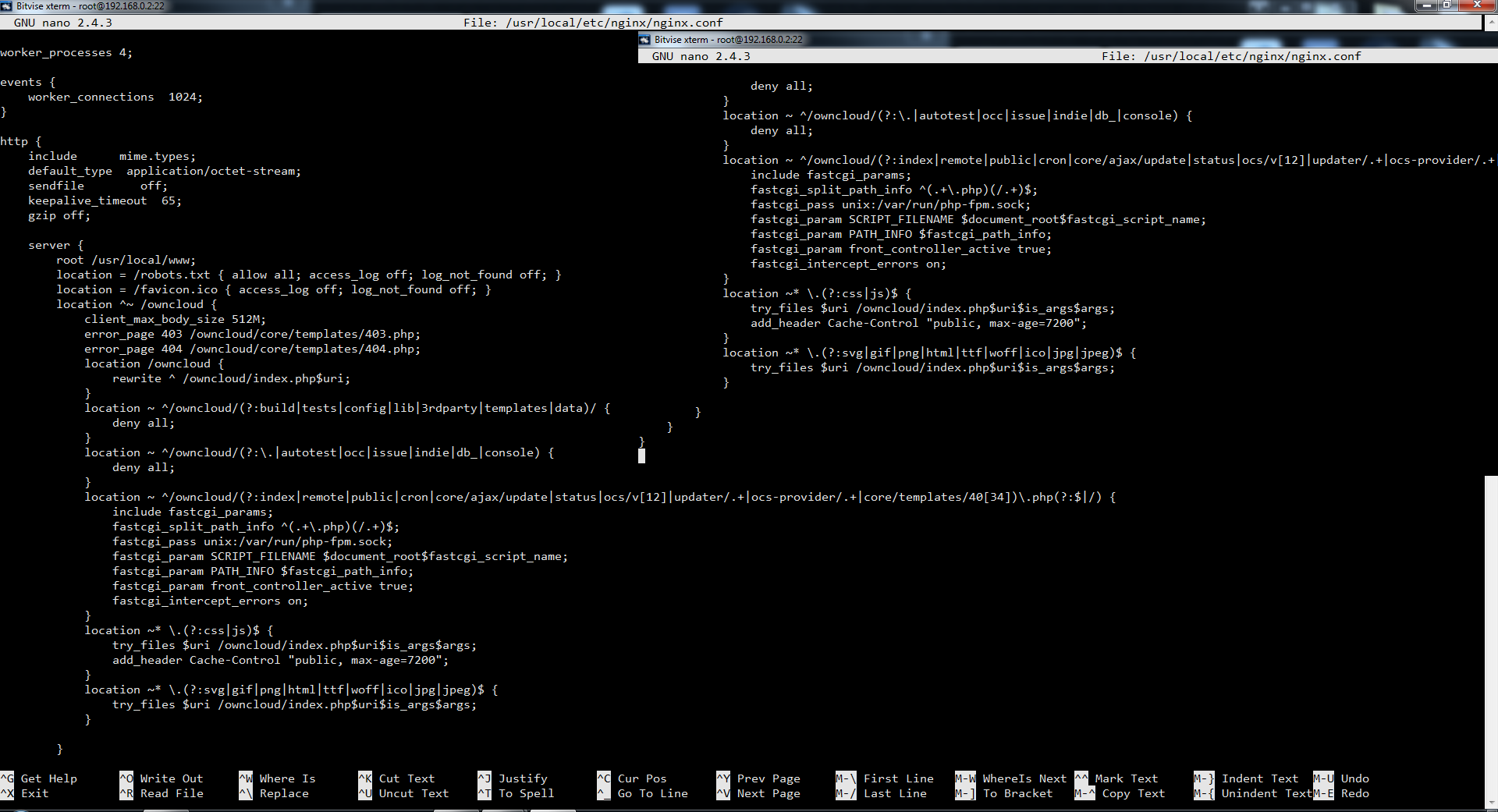

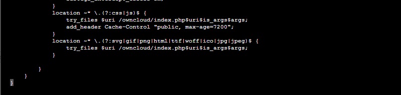

Nothing mate. I restarted the service and the jail. Here are the screenshots of the nginx fixed...
Dec 5, 2011
5,949
Output of 'sockstat' command?
