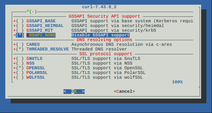

when you did step 4
make config -C /usr/ports/ftp/curl # disable GSSAPI_BASE, enable GSSAPI_NONE
did you actually scroll down and disable GSSAPI_BASE and enable GSSAPI_NONE?

@gaszto @ArgaWoW
Actually, maybe php56-curl is actually using php56-openssl's library. Going top revise the steps.
set WITH_OPENSSL_PORT=yes in /etc/make.conf
service php-fpm stop
pkg delete -f php56 php56-curl curl php56-openssl
make install clean -C /usr/ports/security/php56-openssl
make install clean -C /usr/ports/ftp/php56-curl
service php-fpm start
I might not have the steps perfect but I'm pretty sure we're getting close. When this came up for me I pfixed up my system in a few minutes so this is not impossible.
Also, if you can't get it working there is always the workaround of install apps directly to /usr/local/www/owncloud/apps
Thanks, it worked perfectly. That was the missing step.
