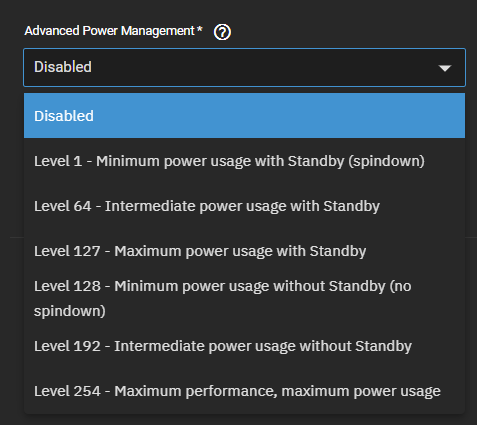

I'm talking about what settings I need for this screen:

rueNAS has tons of power options available, but I'm not sure what I should be choosing. These drives can be written to every hour when a snapshot occurs in my main zpool, but I rarely change data. This is almost exclusively a read-only dataset.
You have conflicting information which makes providing you an answer difficult but I'll try.
Read the TrueNAS User Guide on the drive power levels. There are a lot of threads here about spinning down your drives, that is the only way you will save an appreciable amount of power. Each drive draws about 5 watts of power as a general rule for estimating power requirements. You would need to look at the specific datasheets to know what the drive uses while running vs sleeping for exact values. But if you sleep your drives and every hour they spin back up for a snapshot, even if it's 1 byte, that is generally not recommended here in the forums. Again, lots of stuff here in the forums that discuss that.

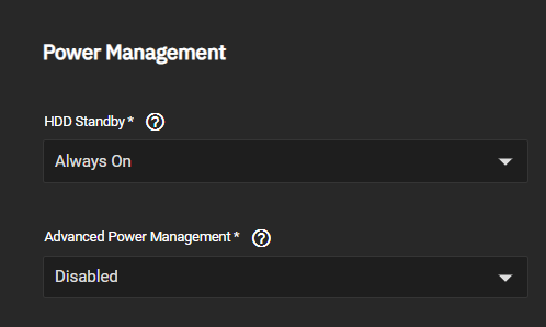

There's this Power Management area in TrueNAS. I figured someone would know more about what settings I could safely use for the longevity of my HDDs vs how much power they draw:

What is the role of the system?
If it's simply to receive backups on occasion, then you can probably get away with spinning down the drives. Otherwise, it's probably not worth it. You might end up using approximately the same amount of daily power, yet with extra wear on the drives.

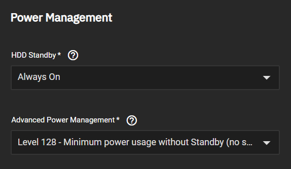

It's 100% only backups for the HDD zpool.
Even the 128 (no spindown) mode is fine with me.
But when I run change the setting, I get "not supported":
# hdparm -B 128 /dev/sdap
/dev/sdap:
 setting Advanced Power Management level to 0x80 (128)
SG_IO: bad/missing sense data, sb[]:  72 05 20 00 00 00 00 10 02 06 00 00 c0 00 00 00 03 02 00 21 80 02 f8 21 00 00 00 00 00 00 00 00
 APM_level      = not supported
TrueNAS lets me set it in the UI, and doesn'st show any sort of warning:
But even still, I don't have enough inside to know how this works.
If you're not going to spindown the drives, then you won't get any meaningful power savings anyways.
Your most meaningful savings in power (hence cost and electricity) would be the power down the entire system, and only power it up to run your backups. This will turn off everything: HDDs, CPU, fans, board. That's a drop from 510W to 0W. Way more significant than a drop from 510W to 500W.

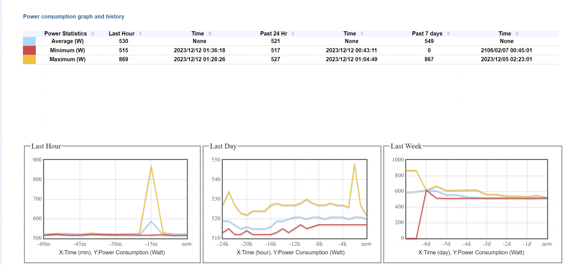

Looks like Advanced Power Management doesn't do anything anyway. I had it set to 128 for the past few days.
These power values are pretty stable at ~510W:
Looks like I have a permanent half-kW of power until I decide to swap these out for SSDs.
My power rates are a fixed $0.08/kWh. That's about $361/yr.
Seems like a lot, but it's way cheaper than cloud storage and for this storage volume, it's also 4 times less than buying SSDs (even consumer models).
I'm satisfied for now so long as my electricity rates stay the same; although, they'll probably go up with inflation and the rising cost of powering electric cars in homes, so this might only be a 2-5 year solution.

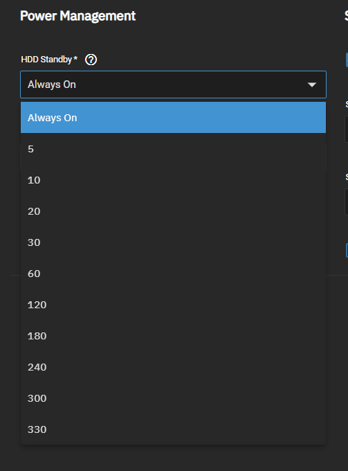

If you really insist on spinning down drives, the built-in functions are not enough, you need to use this:
Making sure the system dataset isn't on the HDD pool will be an essential point too.
