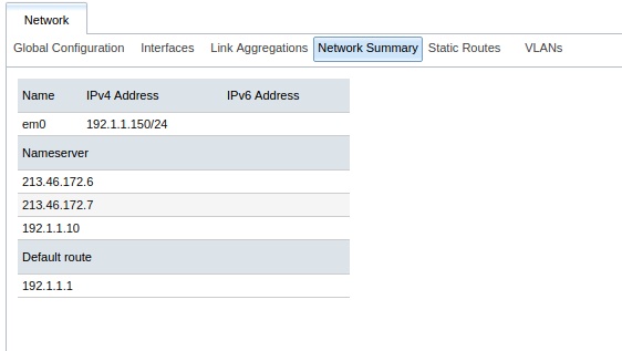

Thanks. I'm a novice and stumbling around a bit, but it seems that there is indeed a failure in connectivity from the jail. I've run this command, which is fine at my server root, but times out within the jail.
time curl -I http://pkg.freebsd.org/freebsd:11:x86:64/latest/meta.txz | grep HTTP
Tried setting the jail configuration to DHCP (it had an IP of 192.168.1.1), and then set it as per the instructions in the original post, but still no luck. I guess I've still got an incorrect setting there somewhere - how can I find out what?

Odd, Do you have DHCP for the jail or static IP? You need to ensure you have a valid DNS for the jail. Check your network settings for the jail.

Update: So, looks like there must be a bug with the Jails in that I am unable to create a jail using a Static IP. I'm rebooting and wiping out the jail to start over. Open an SSH windows to the jail, or open it from the GUI, type netstat -nr to find out if your Gateway is set to 192.168.1.1 (assuming this is your router of course).

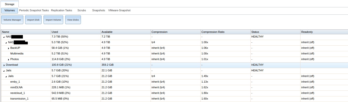

Hi Joe, old man. First off all thank you for marvelous description of installation. ;) Worked like a charm.... almost. I have one tiny thing which bothers me.
[2017/07/28 07:55:07] fatal: upnpevents_selectfds: file descriptor 5770 too big for select, limit is 1024
After 2 hours the minidlna service goes off and this error is only thing which remains in minidlna.log
[2017/07/27 20:46:40] upnpevents.c:423: fatal: upnpevents_selectfds: file descriptor 5770 too big for select, limit is 1024
[2017/07/27 21:33:57] upnpevents.c:423: fatal: upnpevents_selectfds: file descriptor 5772 too big for select, limit is 1024
After completed your guide, I tried these two guides to fix it. But it didnt helped.
- https://svnweb.freebsd.org/ports?view=revision&revision=337482
- https://lists.freebsd.org/pipermail/freebsd-ports/2014-June/093522.html
Please, do you have any idea how to fix this?

joeschmuck
Old Man
May 28, 2011
10,996
@Biolog
If memory serves me correct you are running into a limitiation with MiniDLNA. There is no way around it that I am aware of except maybe to recompile MiniDLNA with the fixes you mentioned above. I can't compile thsi myself, well not anytime in the near future so maybe you can try it and see if you can get it going.
Wish I could be of more help. Well the other thing would be to run Plex and setup the DLNA service on it.

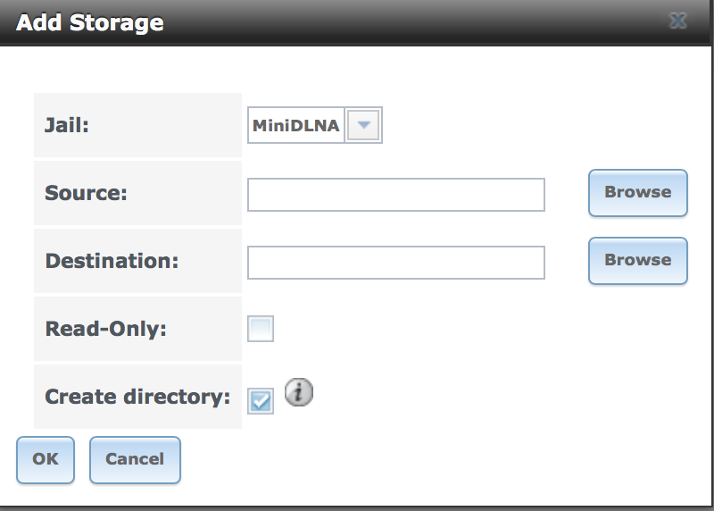

Sheesh, spoke too soon. When I went back to use the server a second time, I cant see the server or the data. Webgui says the jail is running, but when I look at the storage there's nothing attached in the dialog box. I fill it in - still not accessible - and I check the dialog box and it's as if I have to complete it again but it somehow doesn't get saved:
I suspect the fact that my DLNA device does not see the server suggests there's something else afoot. Before I do a re-install, any ideas? TIA
