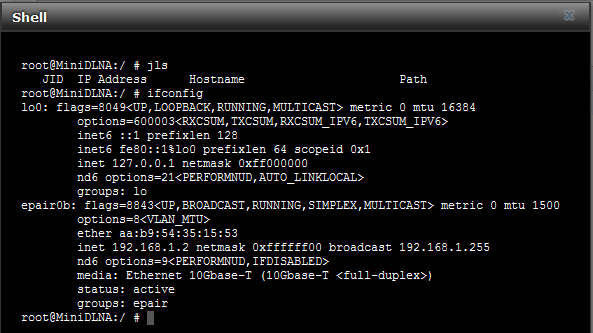

the jls command produces no output under the tabs/headings (see second line in screenshot above). The 'jexec MiniDLNA /bin/csh' command generates 'jexec: jail "MiniDLNA" not found'. My only misgiving in having to re-install a stable os version is I presume I will lose my CentOS VM in that a config file won't reinstall that - or will it? if the answer is no, I'd like to figure out a way to clone it. Maybe CloneZilla from within a basic re-install? Haven't figured out how snapshots work so I suppose that's an option?

The screenshot you provided looks like you are already in the MiniDLNA jail. You would not have a jail within that jail. The key sign here is "root@MiniDLNA". If you had just opened the shell then you would see "[root@freenas ~]", notice the brackets. You don't have those brackets in the above screen shot. At this point, if you were still at this screen I would ask you to type exit to exit out of the jail.
I can't address the issues with other problems you have had but I really wish you some good luck.

Oops! More sleep or more neurons? Doh! etc. It all made sense when you pointed out I was already in the jail shell. Don't know why that didn't click before. The good news is I followed on from there and recreated the jail and thankfully it's now been working for over a week without problems. I've stopped updating the nightlies - mainly because updates kept breaking my CentOS VM - and I await 11.1, the release of which has been put back to early October before crossing the fingers and hoping nothing breaks in the upgrade. In any case, with your excellent tutorial there should be no difficulty - AWOL neurons aside - to recreate the jail from scratch. Thanks again joeschmuck.

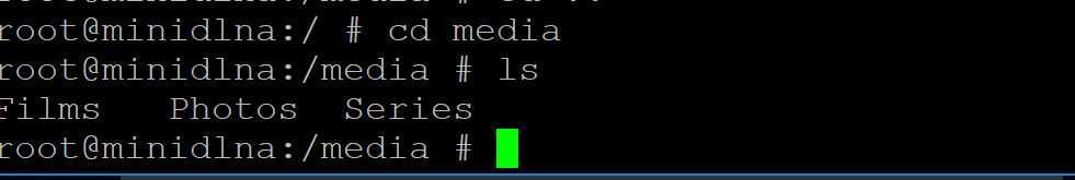

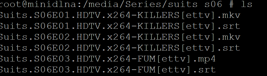

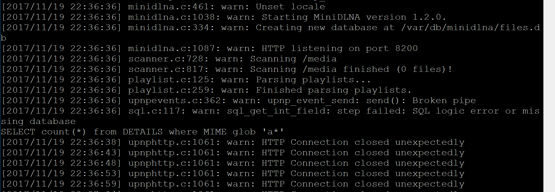

I get some issues with accessing data for the jail.
I had permission denied first but by changing permissions in 774 for the media folder I have this now in the log :
It is said that there is no files by scnaning /media/
Therefore there is as we can see :
Does anyone has an idea ?

What version of FreNAS are you using?
The only problem I see is MiniDLNA is telling you that it doesn't recognize any files. From within the jail what files are listed under "/media/Films/" and "/media/Series" ? Do you have any media? What are the file extensions?

I have different types of extensions as follow (mkv, mp4 ...) :
In my previous install (which was freenas 9 I think ) those same files were recognized.
THanks,

I did check out MiniDLNA on FreeNAS 11.1-RC1 and it appeared to work for me. It's odd that your files are not being recognized. Can you go back and recheck the rc.d file to ensure that is correct, or better yet, delete your MiniDLNA jails and start again to rule out any accidental typo. Also, how are you doing your shares from the GUI? This could also be an issue so try to share only one directory with video content and see if that works.

Concerning the share, /media on the jail is mounted on my Media folder on Freenas. dlna user (the default run user if I'm not wrong) is in the Media group I created within the jail with the same GID that Media group ( owner of my Media storage ) on Freenas.
Whitin the jail /media is owned by Media group with 774 permissions.
Seems ok for you ?
