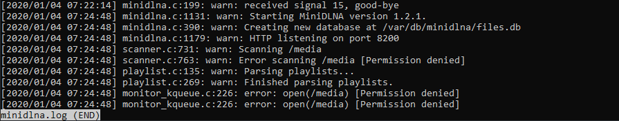

Mondfarmer
Jan 4, 2020
Hello,
Thank you for the guide, worked perfectly for me, until I rebooted my nas for the first time. the service starts automatically as it should but it can't access my media data anymore.
To me it looks like it should have permission to access it but somehow it doesn't work.
Any idea what the Problem is or how to fix it?
Thank you
