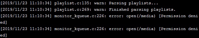

Hi Joeschmuck,
your thread to install miniDLNA in a jail is great! :Dbut in my case, i've tried it and get a known permisson issue at my media folder :(
it looks like a acl issue between the jail and the media source (my pictures) :confused:
several comments are "now it's working" - but no solution how to fix this issue ?
I hope, you have a simple and quick solution to fix the access/permission issue ;)
thanks forward
Hannes

Hmmm... because I had two MiniDLNA instances (for different subnets) I may have done it differently (and it works :));
  1. I created individaul shares (CIFS) in a pool for uploading files for my media (e.g., one each for Movies, Music, Photos).
  2. Once the jail was created I logged into the shell and created three directories on the root of the jail for Movies, Music, Photos
  3. I then shutdown the jail
  4. I then re-configured the jail to mount the directories I created for the shares in the pool to each of the respective directories in the jail
  5. Restart and "Bob's your uncle"

This was also my mindset - but it looks like, the mounted unix dataset&file sstem for e.g. pictures had the incorrect access rights to use and see the recorded stuff :confused: vlan's (in my case) can be onnly configured without DHCP (error message by freenas) :oops:
