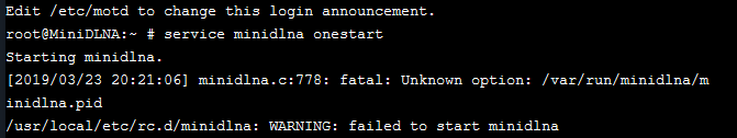

Type "service minidlna onestart" and you should get "Starting minidlna".
