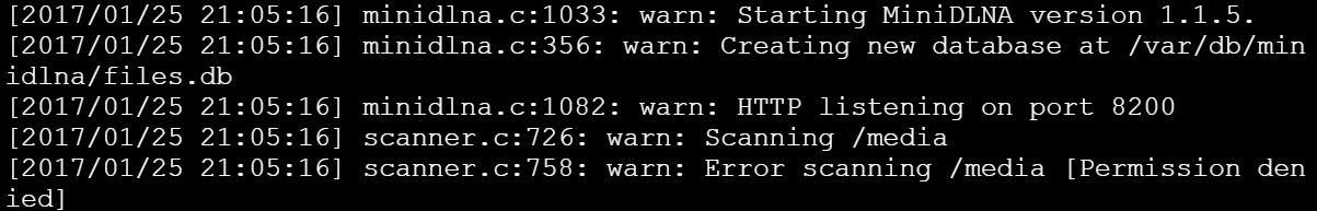

Hello,
I get the installation completed well and all went perfectly. But it seems that dlna server can't access my media folder. In the log I get :
But I did the same as for plex jail.
I created a dlna user and put it in the Medias group in the freenas system. And in the jail system I created a Medias group with dlna user having the same GID that my Medias group in freenas system. But apparently the dlnaserver can't access my medias.
Any idea ? Thanks in advance.
PS : with SSH in the jail I can see my medias but no way to access it on my tv or on my computer

You have a permissions issue so you will need to fix that so you are on the right track.
Thank you for your answer. I restart the full install and did exactly the same as plex install but server can't reach medias for permissions issues I guess. Any usual mistake that can explain my problem ? Except give 777 permissions to my media folder in the jail

I had also problems with that kind of permissions, and of course 777 ist easy and is working perfect. The problems is, that the jail is acting like another computer. So you cannot easily create a user and group and hope, you can access the data. It worked for plex, yes, but this is causing a lot of permission problems in my case and subvert the security. I was then creating a subfolder in a dataset, leave the permissions on the datset on 700, so only the owner is able to do something, and on the subfolder, where MiniDLNA is mounted, I put 704, read only for others and it worked for me. So no one can SSH into that subfolder, and only the jail is able to the the data. After thinking a bit of this, the question is, which user is the MiniDLNA software using, so urdel62's way does not work?
I am not a specialist in this, I can only give you some thoughts and my way to do it.

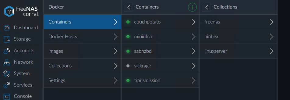

wenceslauneto
Jun 15, 2016
19

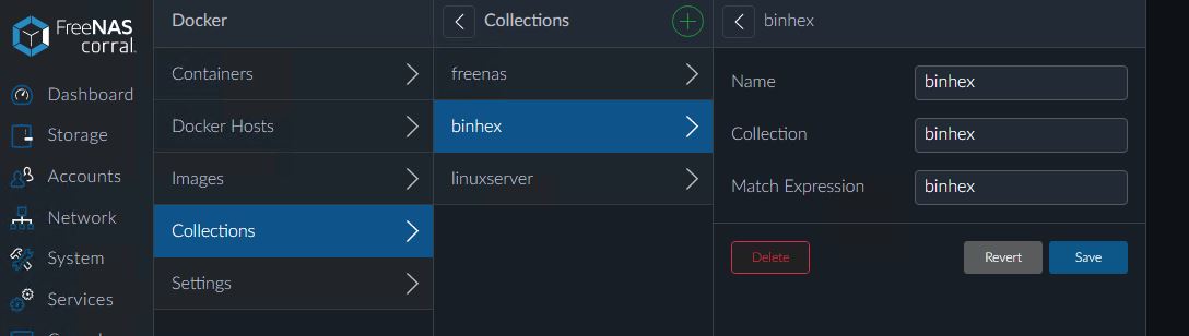

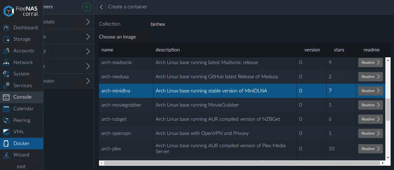

My english is poor, but I'll try to explain my solution.
Minidlna exists in binhex collection on Docker Hub. (https://hub.docker.com)
Create new collection: binhex
Create new Container, using binhex collection
Setup properly the container and enjoy.
