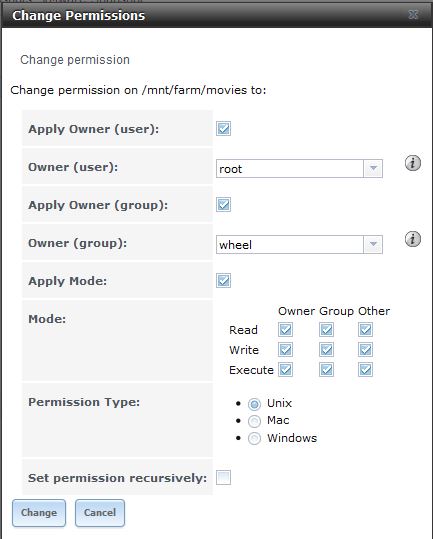

When you install MiniDLNA in a jail it will automatically create the user account 'dlna'. All permissions are automatically created as well.
While I can't get to it tonight, I'll install MiniDLNA again and test it out. Exactly which version of FreeNAS are you running and also inside your jail, type "uname -v" and provide the data from it.
Thanks
EDIT: Here are the permissions I have for my Movies directory:

So I am pretty sure that is is an inherit permission problem. when I was testing this a few weeks ago, the dataset owner was root, now its the user with ID 1001. I think this is the problem. I will look if I can find a workaround for this.
Thank you :)
joeschmuck
Old Man
May 28, 2011
10,996
I just posted an update (screenshot above). You can go in and change the permissions to the files in the folder.

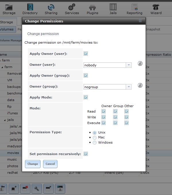

Looking into it, without messing up my own configuration, I have discovered that for my setup I must have the permissions set for OTHER Read and Execute using Unix permissions in order for the media to be shared with MiniDLNA. Of course for my setup I run with Write checked as well but I didn't need it for MiniDLNA to operate. Oh, and I set the user and group to "nobody" and "nogroup" and it worked fine.
IceBoosteR
Sep 27, 2016
503
Hi again,
sorry with stealing your time while struggling around with my problems...
So I will give it a try, I just installed a fresh jail.
Could you please be more precise, where you changed the user and group to nobody? In the jail, on the mountpoint?
Thanks :)
joeschmuck
Old Man
May 28, 2011
10,996
There are no changes in the jail at all.
The changes are here:
FreeNAS -> Storage Icon -> Volumes -> (Select your storage location) -> Change Permissions -> (See screen capture).
IceBoosteR
Sep 27, 2016
503
Thank you for the clarification. I was jist having "Windows" as my permission type - os I will change that. Give me some minutes.
