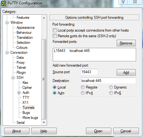

These commands are for the client when trying to access the server remotely (i.e., they may not work on the local network). I have limited experience with Putty, but did get terminal and web access to work via Putty on a Windows machine at work. As far as I can tell, Putty does not allow you to enter Unix commands as such; you have to set settings in the panes to match the meaning of the commands. I can give the details if I get to work today.
A Google search seems to indicate that CIFS/SMB uses port 445. I have not tested file browsing via Windows, as I have no SMB shares on my server.
I found a solution to my first problem using Putty. Under SSH => Tunnels => I filled in port 15443 selected Dynamic and then Add. Save it. Open. And it seems to work just fine now. Is this a good solution or would you change something?
As to my second problem, I'm still in the dark.
For web access, that sounds right.
For file browsing over SMB, as said, I have not done that. But study the command as explained in the original post, and see how you might replicate that in the Putty interface.
ssh -L 15548:localhost:548 -p 52739 <you>@<subdomain>.duckdns.org sleep 120
Of course, you want to change 548 to the SMB port 445, and instead of 15548, use 15443, the internal client port you set above to send things to the server. 52739 should be changed to the external SSH port on your server, presumably forwarded to the server by your router.

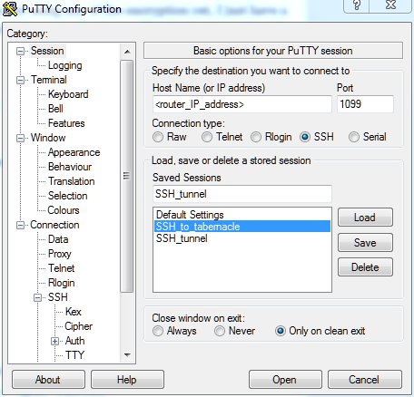

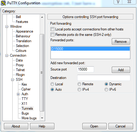

I feel like I've followed everything here to a tee but I still can't manage to get this to work completely. I CAN ssh into freenas remotely, but it seems to be the tunnel and SOCKS setup that I'm failing at so I can't access the webgui. Here's my setup. Disclaimer: I've tried various combinations of these numbers, mostly ip/port combos and what I've read in this thread, but I'm not going to try to list everything. Also note that I'm not using any of the encryption yet, I just have a currently empty freenas box at work that I'd like to be able to manage from home in the future. Thanks for the guide OP, and thanks for any assistance anyone can give.
Freenas internal ssh port: 22
Modem set to forward external port 1099 to freenas_local_ip:22
Modem has static external IP
etc/ssh/ssh_config -> AllowTcpForwarding yes
ssh -D 15000 -p 1099 root@static_ip
works as intended since I've mostly been using the new bash console for Windows
I've tried through Putty as well:
Source: 15000
Destination: freenas_local_ip:80
I've set FireFox as instructed:
SOCKS Host: localhost
Port: 15000
I ssh into freenas and when I try to access anything in the browser, I get "Unable to connect" and (in the console): channel 2: open failed: administratively prohibited: open failed
So it looks like the request is going through but the server is rejecting it, which makes me think there's some setting I haven't flipped on the server but I don't know what.

I'm a little unclear on what the situation is. It sounds like you're saying that tunneling works when you do it from a bash shell, but not from Putty?
In Putty, you should not set the destination to the freenas_local_ip:80. That will mean nothing on the client. Actually, you don't set a destination in the Tunnel pane of Putty. Here's what I think will work for you (the two key putty screens; ignore my saved sessions in the first one):
A couple of other things come to mind. Is Putty set to access your key file for authentication (Connection > SSH > Auth) ? On FreeNAS, is the SSH service set to use port 22?

Yes the tunnel works from the shell or Putty, I can run commands and log in and all that. I can't get the http forwarding to work through firefox like you showed. I am trying to use the webgui from home.
I do not have a key file, I set up the ssh on FreeNAS before I ran across your guide and I have not gone back to the server location since. I did not think that that could be an issue since I'm already able to connect.
I have tried the settings you show (and again just now) and while it still logs in (through putty or bash) I just get a "connection was reset" error in FF when trying to visit any freenas-local ip. I get the "channel 2: open failed: administratively prohibited: open failed" error in the bash shell if that's open while trying to use the browser.

From the remote location: ssh -D 15000 -p 1099 user@static_ip
It then asks for user password
Obviously I can leave out the -D 15000 to get a connection but that command is exactly what I've been using.
I want to reiterate that I intentionally did not create a key file when I set this up. I set up ssh on the testing server on my own, before I discovered your guide. I am aware that it is insecure, but I just want to get it to work. I will generate keys when I'm back on site.

OK, I get it. You're not using key authentication at all, which of course is what the original post is about.
That said, I honestly don't know if the tunneling web access (where you would need the -D 15000) should work without key authentication, or why it does not work. All that comes to mind is open a new tab in Firefox after you do the manual proxy settings. Or try it on a different computer. Obviously there are a lot of things to check on the server, and you may not be able to sort it out until you get in touch with it.
However - you should not need physical access to the server to set up the keys. The keys are normally built on the client, as I described. You could use scp or something similar to copy it to the server using the location/filename as in method 2 of the original post. Make sure the permissions are set right as described in the Troubleshooting section at the end.

I saw that you added it. I was able to run over to the server location and start setting up keys but I couldn't get anything to work. I ran into a bunch of problems setting permissions...when I tried to change my user's permissions it wouldn't save. I think my share or users were set up wrong or something so I pretty much deleted everything to start from scratch.
I do have a decent password but I'm not terribly concerned with security at the moment because there's nothing on the server or network yet and it will all be reset/disassembled/moved soon. I'm just playing around with all this to get a feel for it (and the ability to work from home) before I start doing any real work.
Anyway, after I reset everything I went to change the SSH settings and found that Allow TCP Forwarding was not checked, even though it was set to yes in the config file. I checked it and then I got home I was able to ssh in and go right to the webgui in firefox. Can't be certain that deleting something else didn't fix it, but that seems to have been what the problem was.
Glorious1
Nov 23, 2014
1,211
Great!
