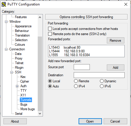

Sorry sir my question was rather open ended.
I have forwarded my ports to the server and I have PuTTY setup the following tunnels
This works great, but I have to individually define the ports I need forwarded.
Any way of getting it the way OP suggested, ie. He opened a Tunnel and set Firefox to use SOCKS protocol to access his GUI via http://192.168.0.250 instead of the PuTTY Tunnels eg. localhost:15443
Any idea how to get the SOCKS method working to access any of the IP's via the web browser?

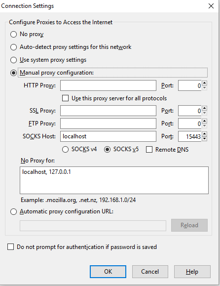

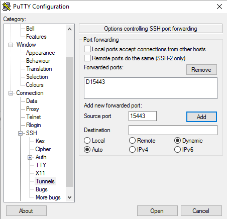

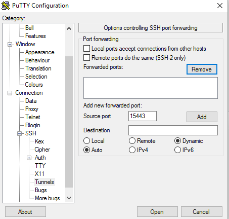

If Anyone wants to get the PuTTY way working you have to set the Tunnel as a dynamic port.
Then you have to set Firefox the way OP has done, and it will work =)
Dont enter a destination, just select dynamic
Once you have done this, setup your browser
And you will be able to access your FreeNAS / Plex / other GUI's just by their local IP's

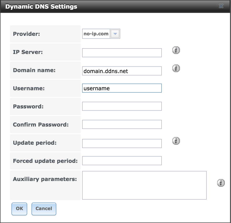

I am able to get Putty to work locally, but not when I try to use duckdns. In the Session tab, I have the host name as <domain>.duckdns.org and the port as 22 with SSH selected. Other settings seem to match what you have posted. I use the same approach as discussed above for forwarding dynamic ports, setting the internal port to 22 and the external to what is set in Putty. The router settings look correct. For all other intents and purposes the settings are similar to what is discussed in the original post, I think at least.
But it wasn't working. I figured that this was because the cron job wasn't running yet. So I set the cron job to run now. When I open the connection in putty it brings up the terminal screen, but then it just sort of lags with nothing coming up and I get a box saying "Network error: Connection timed out."
I'm not sure if it matters that I'm testing this on a computer on the same network as the server.

There's a couple things you can try to try and eliminate what the problem is:
1) Using the DynamicDNS on the same network is hit and miss. I've had instances where it has worked and some instances where it doesn't work. ie: at my workplace if I try to SSH into the WorkNAS via its own DDNS it doesn't work. But at home when I try to SSH into my HomeNAS via its own DDNS it does work.
-> Try accessing your server from another location.
-> I would allow login with pass temporarily and try that to make sure your ports are forwarding correctly.
2) I didn't go the duckDNS route. as OP mentioned there are few other services that FreeNAS has built in. i Use no-ip for example. It's free for up to 3 hostnames and works perfectly. Maybe give one of these a shot if the above didn't work. Although if you ping <yourhostname>.duckdns.org does it show your WAN IP?
If it does then your CRON method should be working. You can check your WAN IP here
https://www.whatismyip.com/
3) What router have you got? could you send a screen shot of how you're forwarding your ports?
Good Luck!
