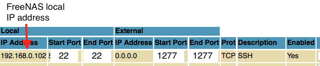

Hello,
@Glorious1 sorry for the delay, had some things I had to take care of. Ok so I went back through your very detailed instructions and checked everything. Here is what I have:
Router
- Forwarding the IP address of the freeNAS from the local port of 22 to external port 1277
FreeNAS
- SSH service successfully on
- have the following CRON job running on 01 minutes every 4 hours and day of the month (everyday), month (every month), day of week (everyday) with redirect stdout (true), redirect stderr (false), enabled (true)
- curl command on CRON job is: /usr/local/bin/curl https://www.duckdns.org/update/mysubdomain/mytoken
- curl command is run as "nobody"
duck DNS
- ensured my IP address is updated and synched with my subdomain.
Thoughts
so the command times out when i try connecting through duckdns while on the internal network and even if i try with the external IP address from outside the network specifying with -p 1277
- the command is successful if i connect directly to the internal ip address of the freenas box.
does this narrow it down to a problem with the router? i have though about this but have tried two different routers (an airport extreme and dlink) but the results haven't changed. is there a way to confirm the curl command is running? maybe that is it?
i really appreciate the help!
Glorious1
Nov 23, 2014
1,211
Hello,
@Glorious1 is there a way to confirm the curl command is running? maybe that is it?
Couple of possibilities.
  1. Cron task. To answer your question, yes. Copy the command out of the cron task and run it manually on the command line. See if you get back OK or KO or neither.
  2. Router
    1. Since you are using different external and internal ports at your router, make sure you don't have them backwards in your forwarding assignment.
    2. Also, the IP in the forward must be the IP of your FreeNAS.
  3. Under FreeNAS, you don't mention what port is assigned to the SSH service. If your router is forwarding external 1277 internal 22, it should be 22.
  4. External port. You may need to use a higher number port. Try something in the 50xxx range. Of course this has to be changed in the router forward and your ssh command.
depasseg
FreeNAS Replicant
Sep 16, 2014
2,874
Router
If this is accurate, your forwarding is backwards. You need to forward external port 1277 to internal freenas IP port 22.
Glorious1
Nov 23, 2014
1,211
Should look something like this (replacing the IP address with yours:
